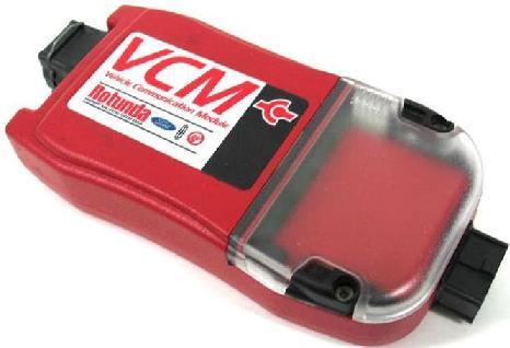

Old Nov 25, 2015 | 02:02 AM
u102768's Avatar
Joined: Jan 2010
Posts: 2,941
Likes: 1,511
From: New Zealand
Originally Posted by philwarner
Do you mean the VCM recovery tool does not work on a Mongoose? Only on a VCM?
Yup a VCM and a Mongoose are different devices. The process Box was describing is only relevent to the VCM.
