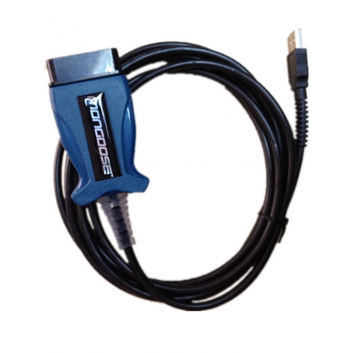

And you definitely have one of these and not a red VCM?

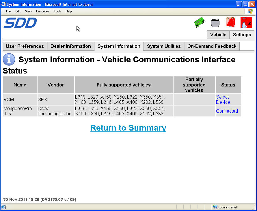

Originally Posted by Box
I do not have a copy of v125. I know I had to go through this issue myself initially, when going backwards from v139, to v138 and lastly ending in v135, and speak from experience from my own frustrations. I do know there are numerous issues that can manifest themselves when using this type of hardware/software with no real licensing and still try to be able to work on your vehicle your own self....
If you load v139 and the Mongoose operates correctly, and you wish to go backwards, you need to start from scratch, install the OS, install SDD, run the patch, install Mongoose drivers to enable the PC to talk via USB, Use VCM Recovery tool to flash the firmware and PROM, restart the box, let VCI Manager see the Mongoose, and then launch SDD. The VCM icon at the top should be green, and if not, it's not talking. If green, you may have to use "Read" on vehicles prior to 2005 or earlier to obtain the VIN.
I removed JLR_IDS v125, set the date back to 11/30/2011 and installed all the JLR_SDD v130 files. I also removed and reinstalled the MongoosePro drivers. I ran SDD and entered the username and password that were listed in the offline authentication pdf, (JLR9A8172 and L538X760) and it said "Details for user identification JLR9A8172 have been successfully authenticated, press continue to begin session". the XP OS recognizes the MongoosePro and so does JLR_SDD; the interface icon is green and it knows it is a MongoosePro, the message at the bottom says "The Mongoose Pro JLR is connected", and the mongoose flashes green at one flash per second.
When I took it out to the SV8 and connected the mongoose to the OBDII and ran SDD, the interface icon was still green, the battery icon was yellow, but the upper right icon was red and still said "activation required" when I ran the cursor over it. It could not "READ" the VIN but took the entry manually and then asked for an "ignition on" test but returned a "Data Collection Error" with the ignition turned on to position II after clicking continue.
OK, So...I am one step further along, but still not communicating with the car except for the apparent reading of the battery voltage via the OBDII. Could the yellow battery icon be holding it back? Or is it the red X "activation required" icon? If it is the latter, is there some other entry needed to activate it off line?
I had just about figured out the menus for v125 but v130 is quite different, although I did find a screen for the interface and was able to capture the MongoosePro info in the picture below. I don't see a VCM recovery tool, but do see a MongooseProUpdater executable file and did a screen capture of its location. I haven't tried it because it seems that SDD is communicating with the Mongoose now, just not with the OBDII.
I am open to any suggestions. I'll try again tomorrow with a battery maintainer hooked up, but for some reason after several successfull VIN entries it is now telling me my VIN is invalid and I know I entered it correctly.
BTW, the pictures were captured inside away from the car so the battery icon is red in them. Oh, And what did you mean when you said "run the patch"? Would that be something within JLR_SDD 130?

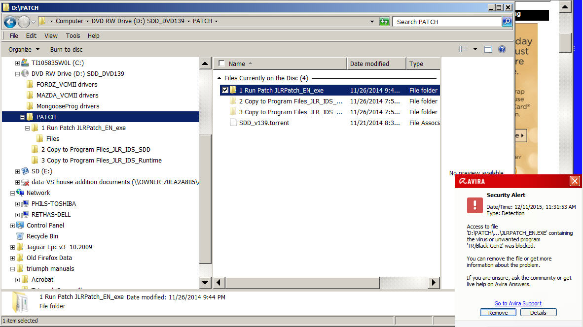

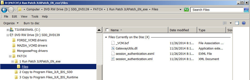

So the new MongoosePro clone works with your version 1.31 software And you used the driver from the JLR 1.39 DVD (DVD named SDD_DVD139)?
Is your software activated (beacon icon in the upper right is green)? And if so how did you do it? My V130 said it had been successfully authenticated when I entered the user and password, but the little beacon icon is red and says "activation required" when I cursor over it. I am assuming that is why my Mongoose Pro does not communicate with the OBDII beyond showing a yellow battery icon.
Did you run anything from the Patch folder on the 139 DVD? I was just looking at the files in that folder on the DVD and got a virus warning from Avira just now.
Attached Thumbnails Bad Mongoose?-jlr-patch-virus-warning.jpg   Bad Mongoose?-jlr-patch-virus-warning-2.jpg   Bad Mongoose?-jlr-patch-files.jpg
