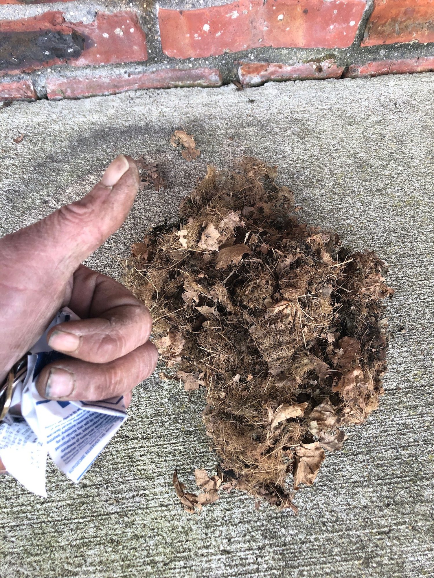

Hey all new guy here 2004 xj8 vp with a few issues.
Heater blower
was noisy and no air came out of the vents.Saw posts about hooking out insulation but couldn’t figure out what everyone was talking about so I dropped the motor and found this inside.Also hooked an equal amount out of the vents around the blower. Pain to remove but did the trick.
