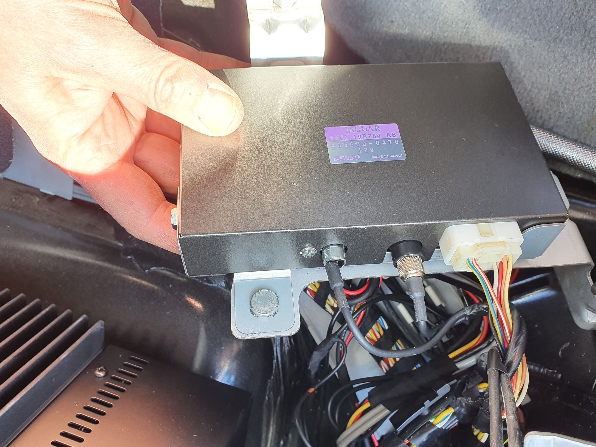

Hi,
The part module says Jaguar 1X43 19B284 AB 433600-0470 Denso made in Japan.

On many yahoo action offers it's called Analogue TV tuner
Reply 0
Mar 20, 2021 | 12:26 AM
Per Sochi, definitely TV Tuner
ヤフオク! - J72RAジャガーXJ8 テレビチューナー 10765JJ (yahoo.co.jp) (use your own translate, I got an error)
Presumably for the rear seats, in which case you will also need to consider a chauffeur's cap.

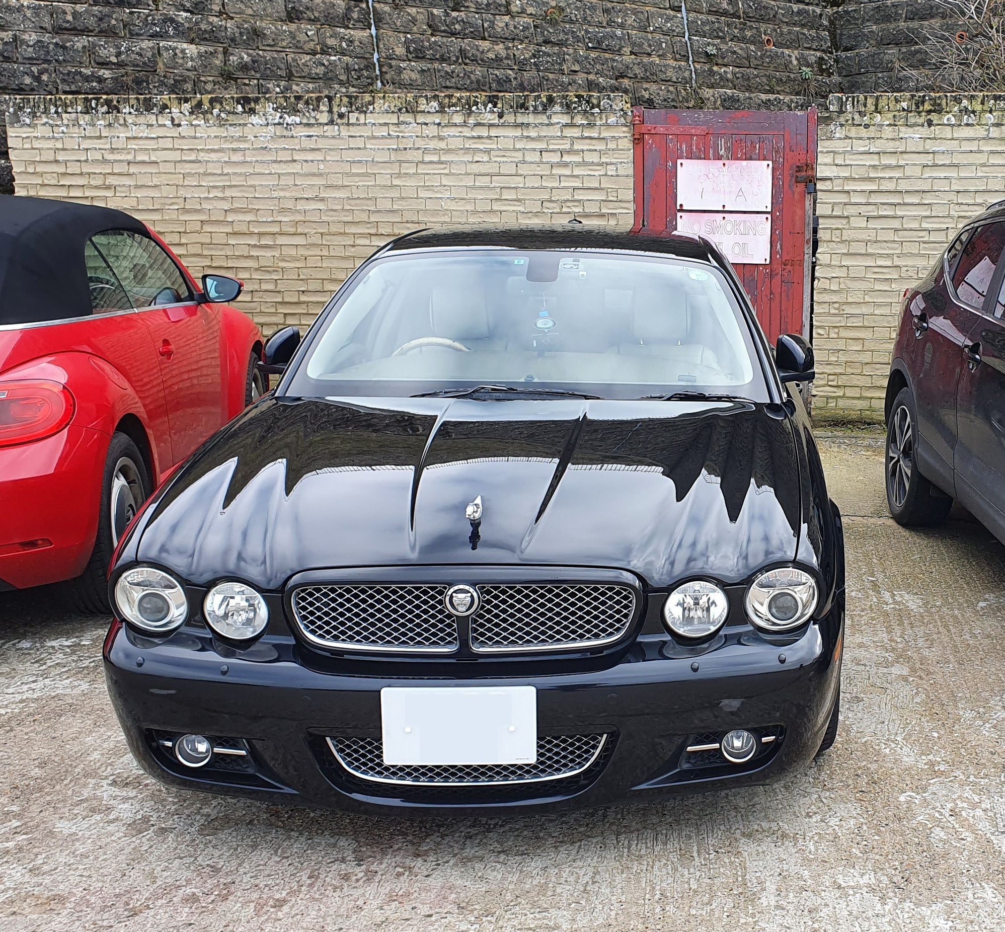

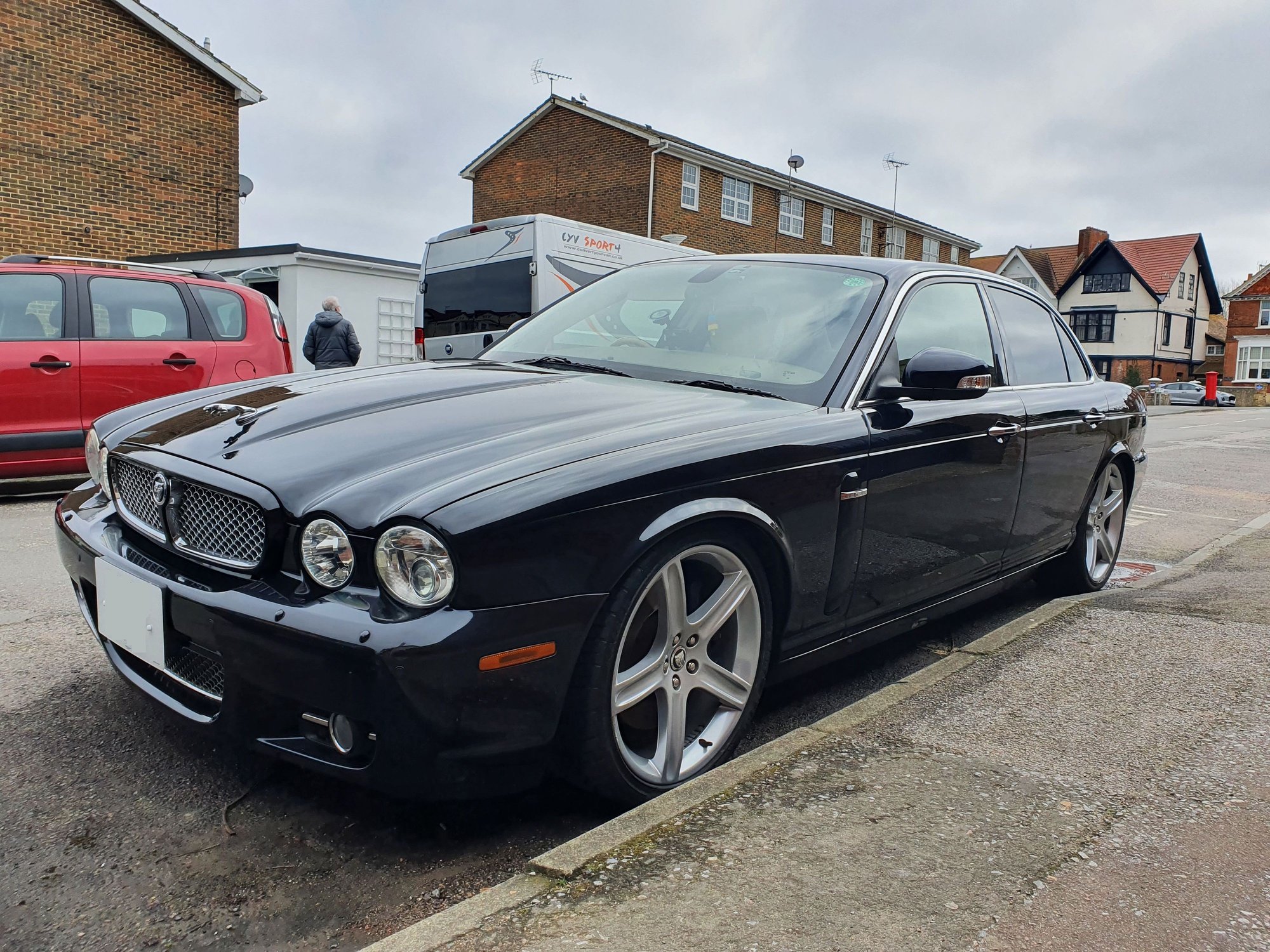

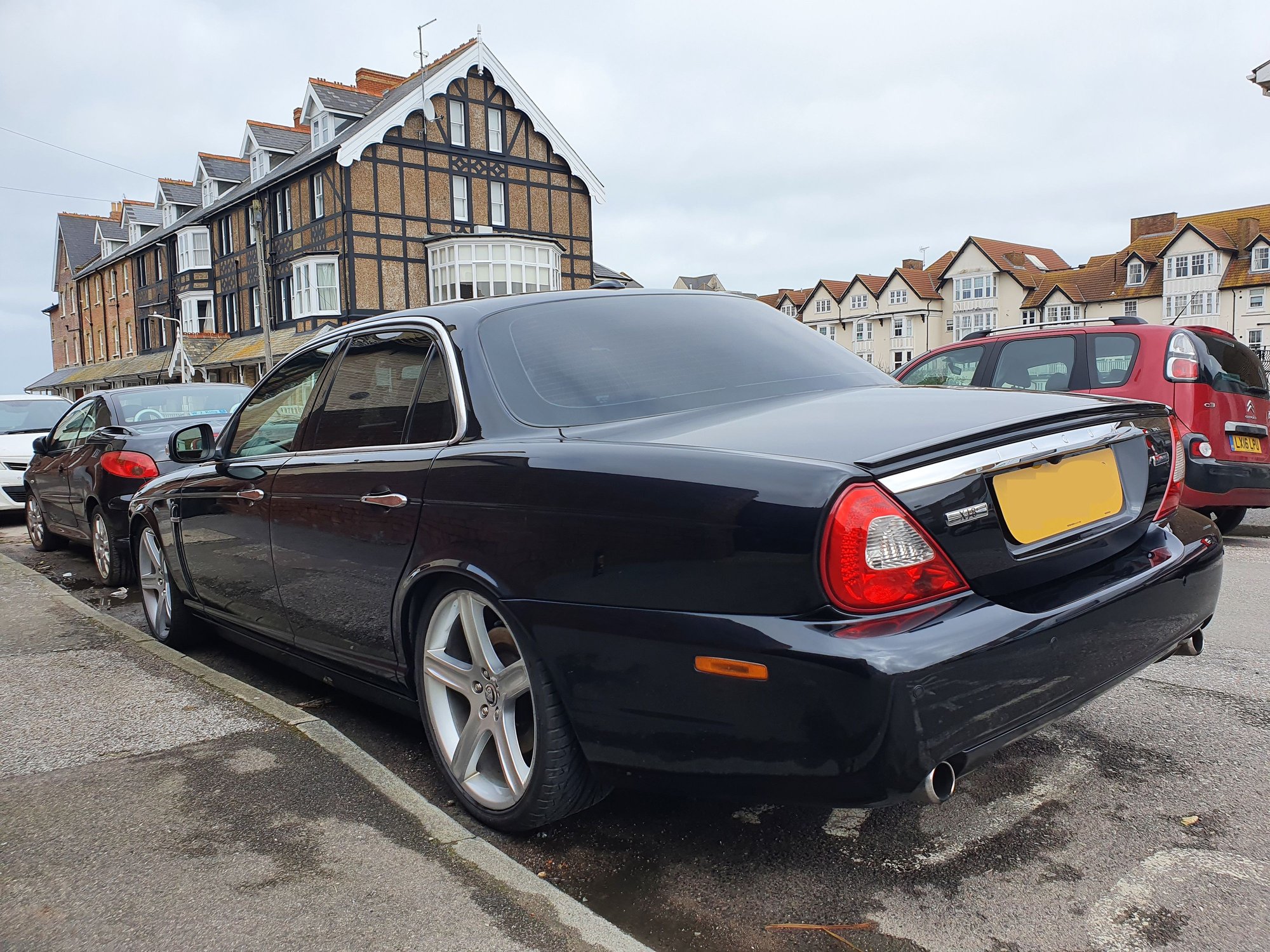

Hi,
Thanks for that. Well I am not going to be able to get Bluetooth (or TV) using that module
Polished the car this morning, here are some pictures. Arms still hurt!

Wow, great looking car, Nick. Same as mine (colour, interior, wheels}, but much more mint. Do you have the 4-zone aircon? Oh, and mine's close to 200K Km, so well run in. You've got a very good one there. I wonder if they were Yakuza staff cars, same colour and trim etc?
