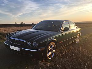

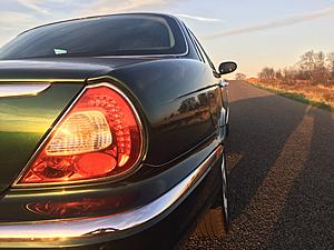

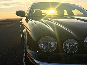

Well, today has been a jolly nice day, and not just the weather, as I picked up the XJ6 today. Without further ado, here's some pictures.
So, what's it like to drive? Well, my three hour long drive back home through the outstandingly beautiful Peak District this fine and sunny afternoon will rate as one of the most enjoyable drives of my life.
Wow! Just wow.
I'm verging on gobsmacked. A 1700kg luxury waftmobile should not have such a wonderful balance of ride and handling. I honestly do not know how Jaguar have managed to do it. The vehicle wafts along in almost complete silence, as if it's riding on a magic carpet made of fluffy little clouds. Even the large 19" alloys do little to detract from the sublime, cossetting, magic carpet ride.
And then you put your foot down.....
It may only be a 3.0 V6. It may only have 240bhp, but the engine spins up freely, revs nicely, pulls cleanly to the red line and makes a not unpleasant, but slightly muted howl. Triple figures speeds come around with surprising ease.
As for the handling? Blimey. It honestly, really does handle very, very nicely. OK, so the steering is a little numb around the straight ahead, but tilt it into a corner with a-gusto and it is just remarkable. It corners so flatly, the steering comes alive, grip levels are communicated, ever so slight understeer creeps in, but a slight lift of the throttle, or if needed, a breath of brake with the left foot and the thing comes back to heel. After an afternoon spent hooning around the Peaks, I had a smile on my face a mile wide. Driving many modern vehicles is like driving under the effects of anaesthesia, but the X350, when pressed, is an absolute delight. I don't know how those chassis engineers at Jaguar did it, but my God, they created a masterpiece.
Any bad points? Yes, a couple more have reared their head. The air-con only blows warm, the rear blind doesn't work, (although I can hear the motor running), the brakes have got quite spongy after a prolonged bout of spirited driving, and earlier on this evening it developed a slight hesitation on partial throttle openings. Not a missfire as such, more a lumpyness or a hesitation. Hopefully plugs and a fuel filter will sort that out? I'll be going down to my local library in the morning to take out a copy of their Hilliers so I've got all the relevant technical specifications, so at least then I'll know what fluids and plugs to buy. Never-the-less, none of this detracts from my happiness with the car. Despite a few niggly faults, I'm very, very pleased with this purchase.
So, how much did this bundle of joy cost me? If I told you, you probably wouldn't believe me. In fact, I can barely believe it myself. Jaguar X350, used luxury saloon bargain of the decade? Quite probably so.
