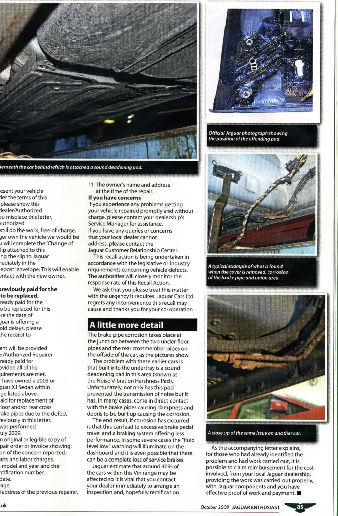

Real-Tech answered one of my posts pretty recently with the location of the inspection. He said it was the right side undertray. My car is a SW car in a dry climate, with no snow and hardly any rain, so fat chance I had a problem, but I wanted to make sure I was inspecting in the right place.
