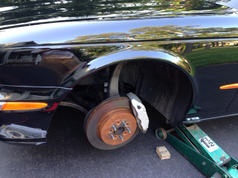

Recently developed a pulse while braking, so performed a pad and rotor change on the front axle.
Thanks to forums members for advice, etc. in performing this job. Here are a few pics and part numbers for review.
Used the Akebono EUR938 ceramics for pads and the Eurospares C2C8355R.
Ordered the pads from Autozone; delivered to house for about $80.
Ordered the rotors from eBay (parts container) for about $166 delivered.

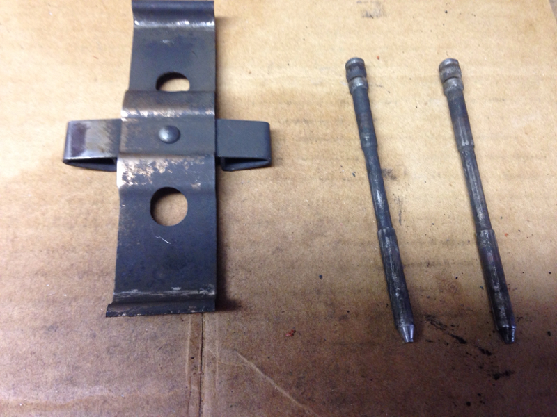

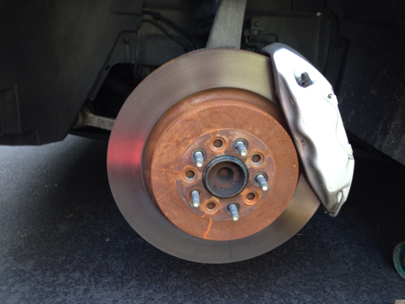

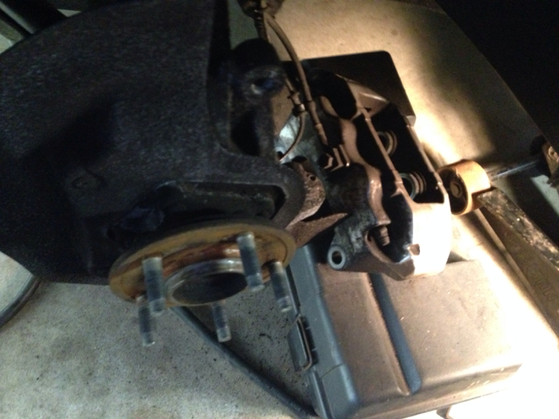

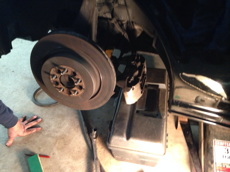

Please see the following photos:
Old rotors and brakes
Caliper and old pads
Pad clip (spring) and pins
Caliper removed
Old rotor Pistons ready to be compressed
New rotor with caliper reinstalled
New rotor passenger side
Tip: Had a difficult time with the car on jack stands to get enough torque to remove the caliper bolts. Ended up purchasing a 800ft lb. air impact wrench at Home Depot. This tool removed the bolts with ease.

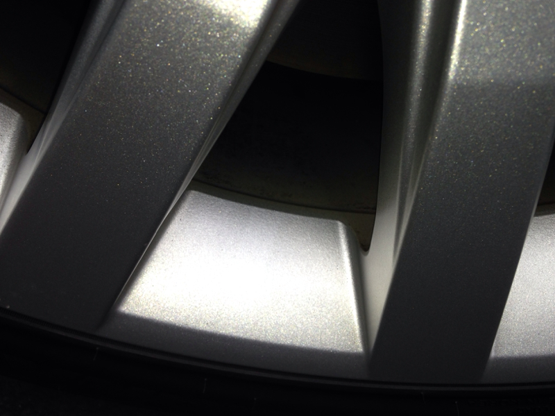

Update... It's been about 400 miles or so and the front brake and rotors replacement seems a success.
Wanted to add support to those who recommend the akebono ceramic pads.
Have a look at these pics showing front wheels (ceramic pads) and the rear wheels (oem style) pads.
For illustrative purposes, I did a "finger swipe" on the rim to highlight the level of dust.
Now if the rears weren't only 6 months old, I would be placing ceramics there too!!
The wheels had been cleaned about 250 miles prior to the pics.
Attached Thumbnails Brembo Pads and Rotors Replace-image-972417093.jpg   Brembo Pads and Rotors Replace-image-470045242.jpg   Brembo Pads and Rotors Replace-image-4251893447.jpg   Brembo Pads and Rotors Replace-image-809912067.jpg
