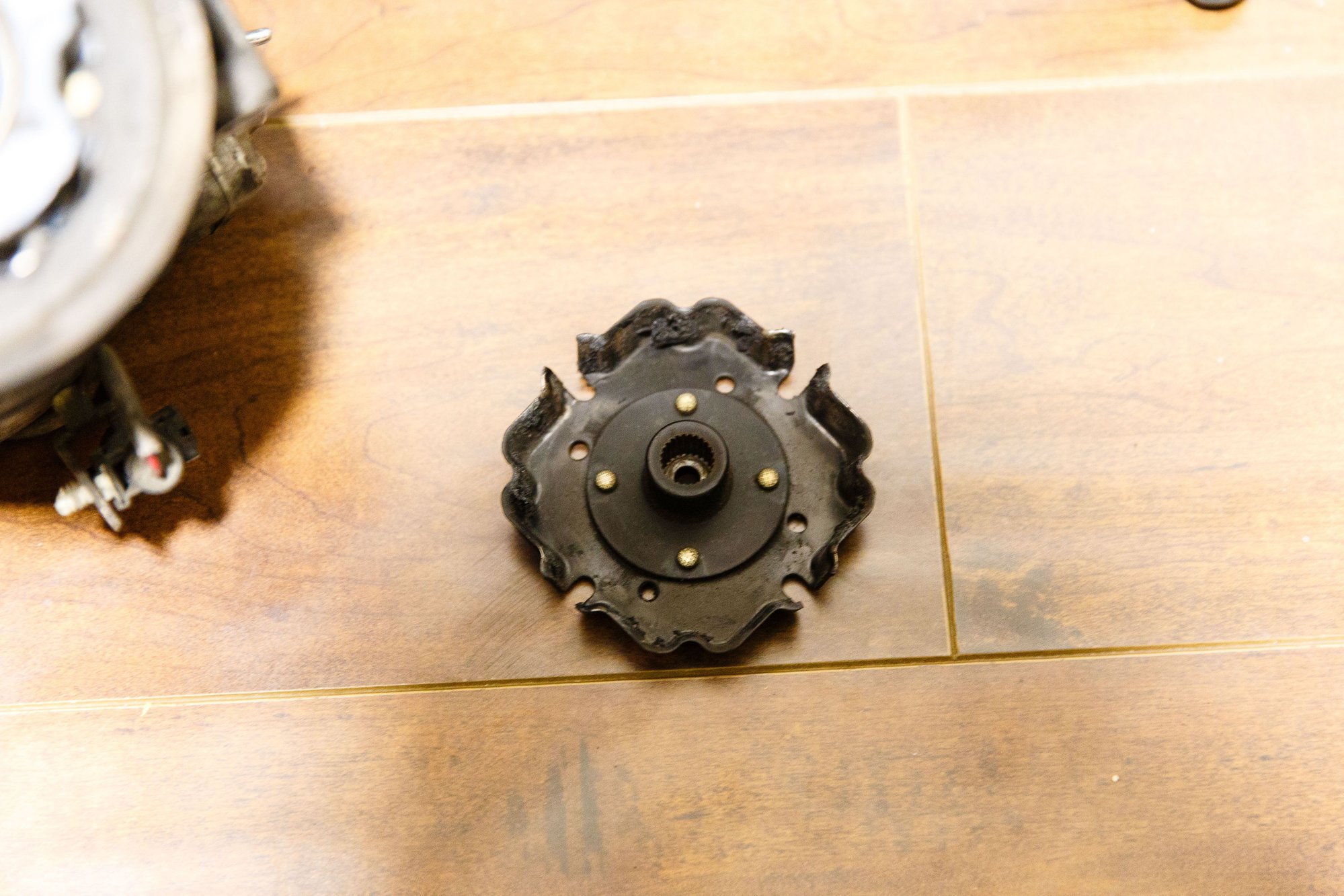

It is a clutchless system that is always on. The climate control module (CCM) determines the proportion of duty cycle (from 2-100%) required for the temperature setting and cabin conditions. None of it runs on a 12 volt system, therefore supplying 12 volts to force the compressor to activate is not possible as it runs on a pulse bandwidth modulated signal. The pressures transducer (what you referred to as the low-pressure switch) receives a reference 5 volts from the CCM and returns an adjusted signal voltage back that is correlated with the pressure measured in the discharge line
All this to say, the system is difficult to override. Check to see that the square drive 'module' (I don't know what to call it) is spinning with the compressor pulley. If the compressor becomes seized, this object is a sacrificial part that will become divorced from the pulley, preserving the accessory drive belt. If you see it stationary while the pulley is spinning, then the compressor will need to be overhauled or replaced.
This is the compressor. The square thing on the pulley connects the pulley to the compressor driveshaft.
Here is mine removed from the compressor. Normally it is epoxied to the pulley. Mine had sheared as my compressor pistons had become seized.
I think I and, more so, many others have written a great deal about this system. Try and do a search on this forum and you will be rewarded with a lot of information to parse. Good luck with the troubleshooting and repair!
