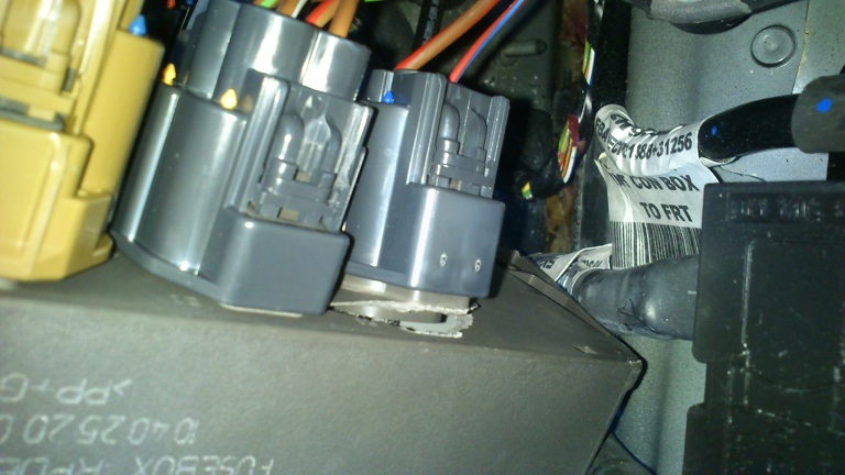

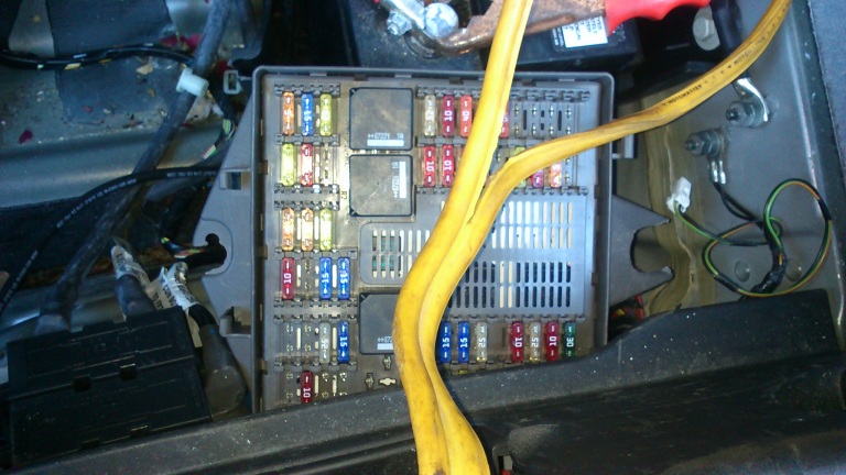

Here is what I discovered at the back of the fuse box. Both the dark grey plugs in the pictures were unplugged. I connected them both back in and the ebrake module started working.
If you notice one of the plugs is ripped at the fusebox. Could this be the issue? How can I check if that is the issue?

The fuse box looks broken. May need to be replaced. Yes those 4 connectors do need to be plugged in to the bottom of the REM.
