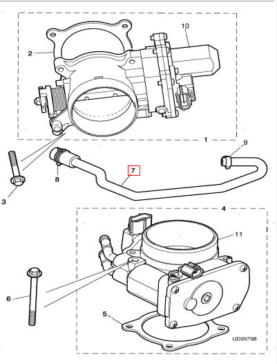

That's correct the hose is different diameters from the throttle body (small dia) to the back of the water pump (larger dia). see attached photo. and on the parts drawing is item 7

Attached Thumbnails Car overheating-s-type-throttle-body-hose-2.png   Car overheating-draper-89793-remote-hose-clip-pliers.jpg   Car overheating-aj811763-hose.jpg

You should manage it with just the Throttle Body removed, at the air manifold flange.
The hose turns back from TB & the air manifold around to the back of the water pump at the front of the engine. In the photo you have in post #10. Where you could see the tip of it, and a larger diameter hose section.
The old hose may have crimps, the new one should come with the hose clamps.

When your happy, everything works, and no leaks when the coolant system is pressurised, (Like all good cook books) Allow to cool before draining and refill with your chosen coolant mix. Top off with water as required and keep a good eye on the water level and expansion tank level alarm for the next week or so.
I had mine up on a ramp which seemed to help, getting the air out. Drove up and down a hill and managed to get about another 2 ltrs in the expansion tank.
Hope this helps.
