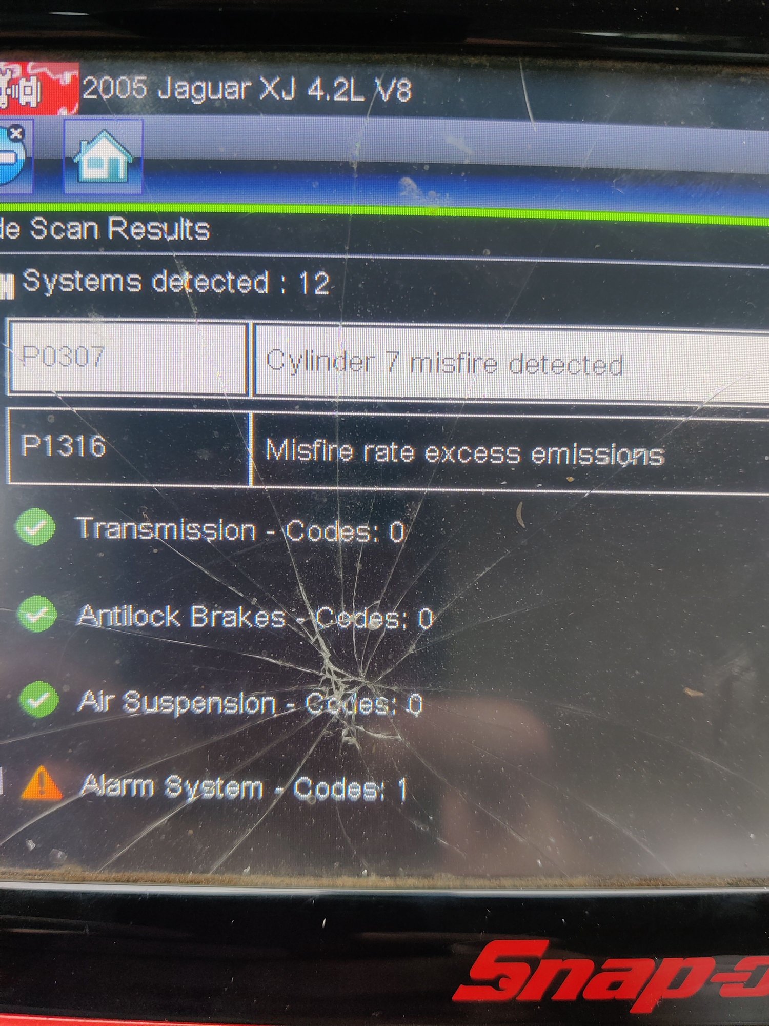

My check engine light is blinking and I have a restricted performance message. I changed my spark plugs also #1 and #8 coils. Still doing the same thing. Please help. Thanks

That gets real confusing fast!! Always clear all codes after reading them. Now the dumb parts stores are starting to refuse to erase codes for some reason? We only want to work on what's currently bad as the system records and keeps all kinds of things that are temporary and do not repeat. Also as you fix multiple problems the error codes will change. This is the main reason it's best to fix problems as they happen. When the car has several problems at the same time it's MUCH harder to troubleshoot it.

From the codes it looks like you have injector issues rather than plug or coils. A short circuit to ground will keep them open and ruin the cats.

from what i see. you had two misfire codes replaced coils and plus and now you have a injector code? if this is what happened check to make sure you didn't unplug / damage cylinder number 1 injector connector or wiring. and always follow up with findings / repairs made on your post so we know what you found and maybe it will help others.

Default I cleared the codes.
I cleared the codes and rescanned.

To get rid of an easy one first I would disconnect injector 1, front right hand side sitting in drivers seat, and check its resistance. Compare to one from left bank, you have no codes from left bank, to see if number 1 is good internally. Also test each injector 1 pin for resistance to its body - should be infinity. Test the NR wire on the connector, It should have greater than 12 volts with the ignition on. I would test resistance on 3 and 7 also, since there are codes related to them as well.
