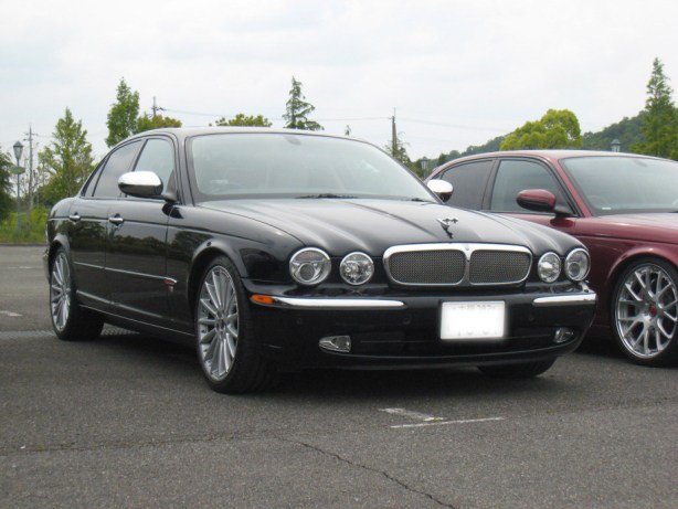

Default Black window trim
This is what I might do to my VDP....
Black Trim looks better, less upkeep.
Attached Thumbnails chrome around glass cloudy-xj8-black-trim-red.jpg   chrome around glass cloudy-xj8-black-trim.jpg
