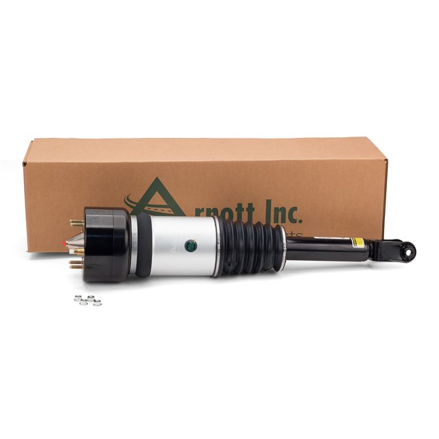

The Arnott air shocks on my SV8 dated 18.09.14 have the same part number of AS-2710 but look quite different from the photos of the new ones you posted. Are your new ones actually Bilsteins that preserve the CATS system? I am wondering if mine could be the source of the slight clunk I still have after replacing the stabilizer bar bushings, the left engine mount, and the transmission mount. Can you post a photo of the old Arnotts?
Mine were installed at the auto lot where I bought the car and had 1,200 miles on them when these photos were taken. I've driven another 2,200 miles since then and the ride has always seemed a little harsh, but I am comparing it to my 87 and 85 XJ6s with 15 Inch wheels and tires with lots of side wall.
Attached Thumbnails Clunking in front end, driving me crazy!-sv8-underneath-9-8-2015-22-.jpg   Clunking in front end, driving me crazy!-sv8-underneath-9-8-2015-25-.jpg   Clunking in front end, driving me crazy!-sv8-underneath-9-8-2015-26-.jpg

I am also glad you cleared up the Bilstine/Arnott question. I had read somewhere that Arnott no longer offered rebuilt Bilstine units and supplied only their own design and checking their web site I see only the new units listed, but apparently there are exceptions. It seems odd that they used the same part number for your rebuilt units, but I can understand it if the rebuilts are not a common offering and they used the labels on hand.
As rebuilt OEM Bilsteins I would guess you still have the CATS functionality which, If I understand correctly, uses an electrical current to change the damping characteristice of the fluid in the shock. I am surprised that they seem harsher than the Arnott design unless the cores they had were the sport version rather than the comfort version.
The photos on the Arnott web site show a bellows design that appears to be half way between the units I have and the rebuilt Bilstiens you received. It does not appear to be clamped to the shaft as yours are.
Info from the site says:
Additional Information: AS-2710 replaces Arnott Part AS-2519 which was formerly sold only as a pair.
The Arnott designed Jaguar replacement shock has internal dampening and will come with a bypass sensor built in to bypass the Jaguar CATS and message on your dash. This shock can replace both the Sport and Comfort OE shocks with a ride that is neutral.
Thanks again for clearing up my questions, and good luck with your new air shocks. That is also quite a nice collection of luxury cars in your stable; Our SV8 may be the last luxury car we ever buy as long as it holds up with no expensive problems beyond tires and a few more bushings.
