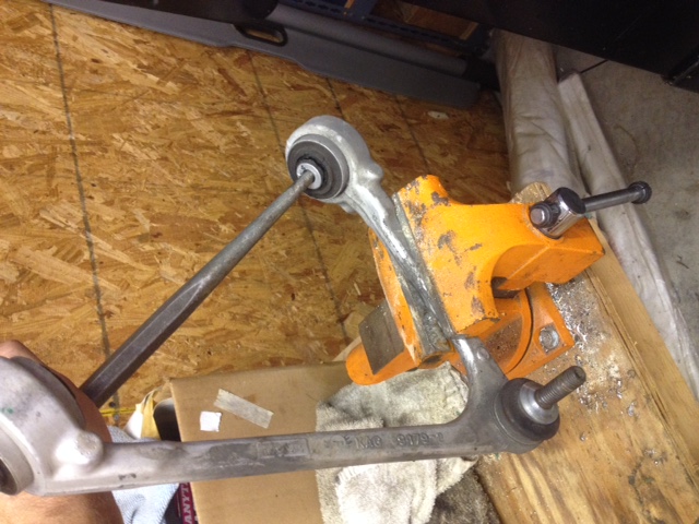

Default FINALLY Solved Clunking sound.
After many new parts, the clunking sound at low speed is finally solved. Along the way I replaced the following: sway bar bushings, front shocks, lower front control arm bushings and upper control arms. The XJ8L has 153,000 miles and I am the original owner. The sway bar bushings were a little loose, but new ones didn't solve the clunk. The shocks were still working, but probably were nearing their useful life. Replacing those with new Arnotts didn't solve the clunking. The lower front control arm bushings fell apart when I took them out. After pressing in new bushings, that still didn't solve the clunking problem. The new upper control arms finally solved the clunking sound. It turned out to be the front bushing on the right hand side. It was broken and had a little bit of movement. I couldn't detect any movement until I took the control arm off. While the arm was on the car it felt rock solid, even with the connecting arm to the hub detached.
What a nice ride to not hear that clunk every time I hit a small bump at slow speed. I am sure there are some other bushings that need replacing, but for now I am happy that the clunking sound is gone.
