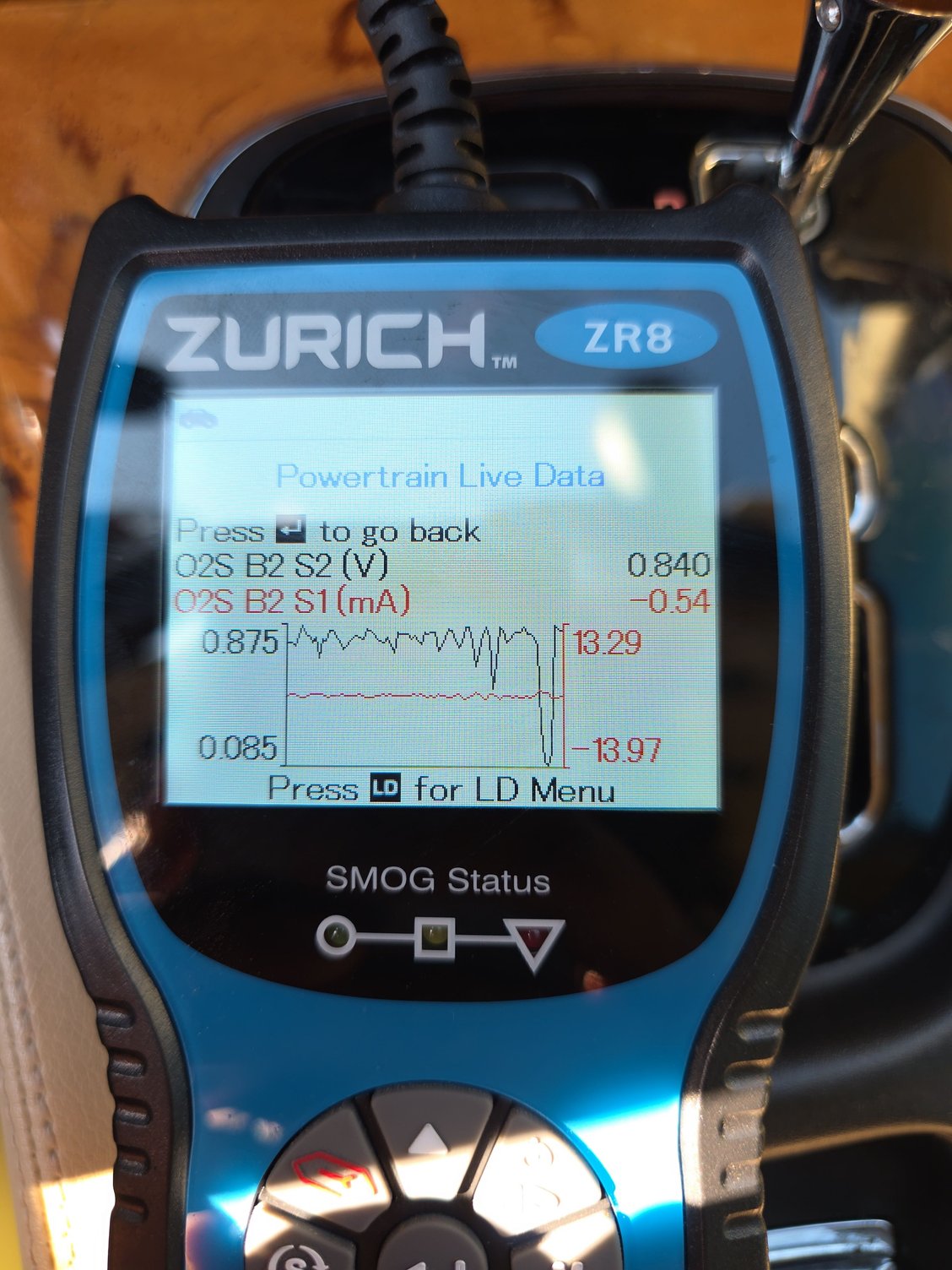

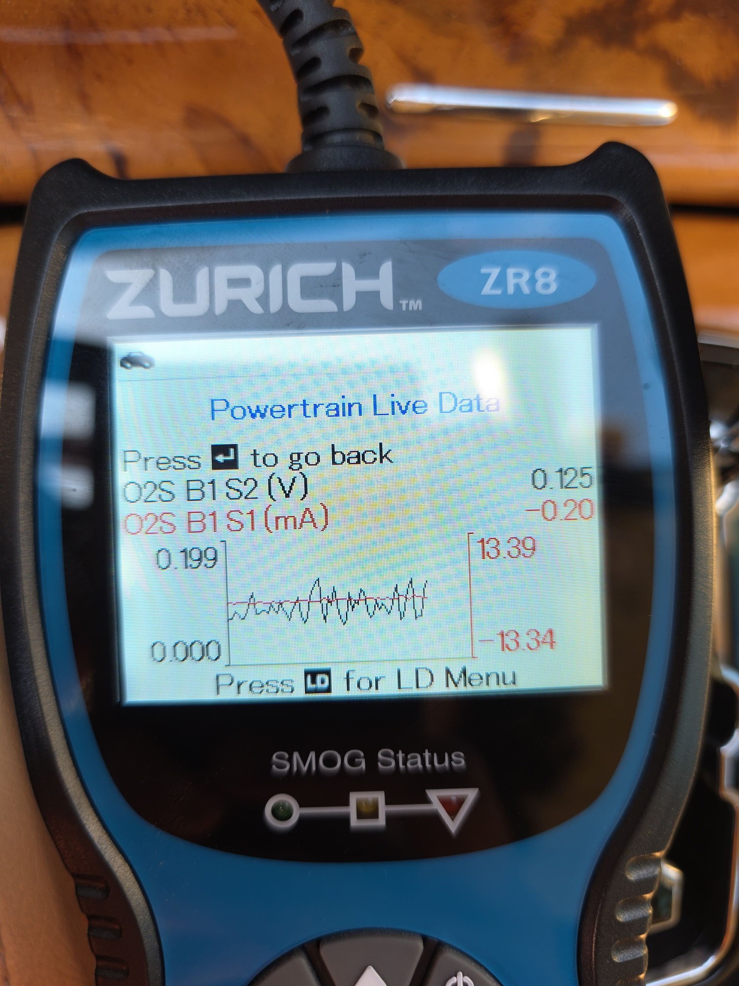

Here's a few charts of the live data on the sensors running at idle.
My guess is a potential air leak? I am not sure if the fluctuation in Bank2 downstream suggests a busted Cat. Any ideas on what I could do to diagnose would be much appreciate it. I really like the car and I want it to last as long as possible.

Yes, we swapped downstream sensors and the issue stayed in bank 2. Also, I tapped bank 2 Cat and it rattled a little bit. For now I just have a scanner handy so I can clear it and make sure that's the code. Will probably end up getting a new aftermarket cat.

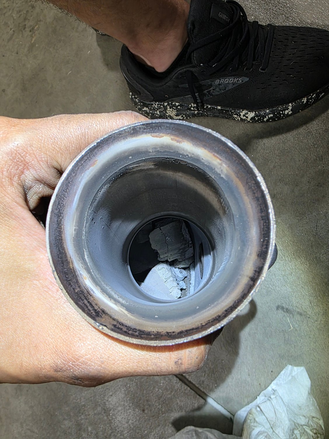

Well, the code does seem to be as accurate as it gets. Inside of that cat looked like it was ready for smoking aome ribs.
One of the honeycomb was absolutely in shambles. On first drive back home it felt noticeably better when accelerating and held speed for longer when cruising. We used an Ebay direct fit part which, well, fitted perfectly. Only time will tell if it lasts enough. Thanks everyone!
