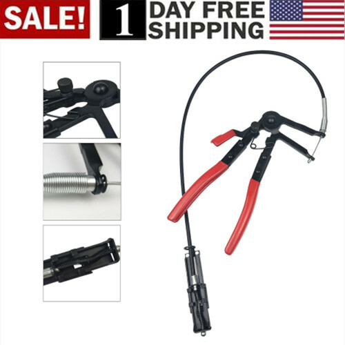

Default Invaluable clamp tool I use whenever working on hoses

Nowhere near as versatile as the tool I noted as you have just as much trouble accessing clips in tight locations as pliers.
The tool I use allows much easier access to clips on hoses in tight locations with the ability to rotate a clip easily to get it located properly.
You just cannot do that with pliers of any type.

Have never seen the vise grip tool you show.
Good sized ends on them, looks like they work well.
I have used tapered nose type vise grip, as well as the regular type of various sizes.
Also over sized pliers, channel locks, etc.

when you try to use that tool to slip over different hoses that are a bit tight youll then understand why a "professional" uses both. And most often the one i listed a picture of i use most often. You already posted the pic of the cable driven one so i say no reason to post again. Again i find the cable one i use way less than the pliers and i do these all day long

I have done the same as you with a LOT of frustration accessing the hose clips around the radiator.
When I discovered the tool that I pictured it was like night and day accessing hose clips in tight spaces. It was so easy to attach the clip attachment on the tool to the clip and
release the clip but more importantly was the ease in which I could replace a clip with the ability to maneuver the clip to the position I wanted.
As I say night and day. The tool is not expensive on Ebay which is where I got the picture.

john, the lower radiator hose clamp and several on the 2.0turbo are about the only places i have to use that tool. And youre correct when dealing wtih the hard ones its a god send. Why i have both tools at work and home.
