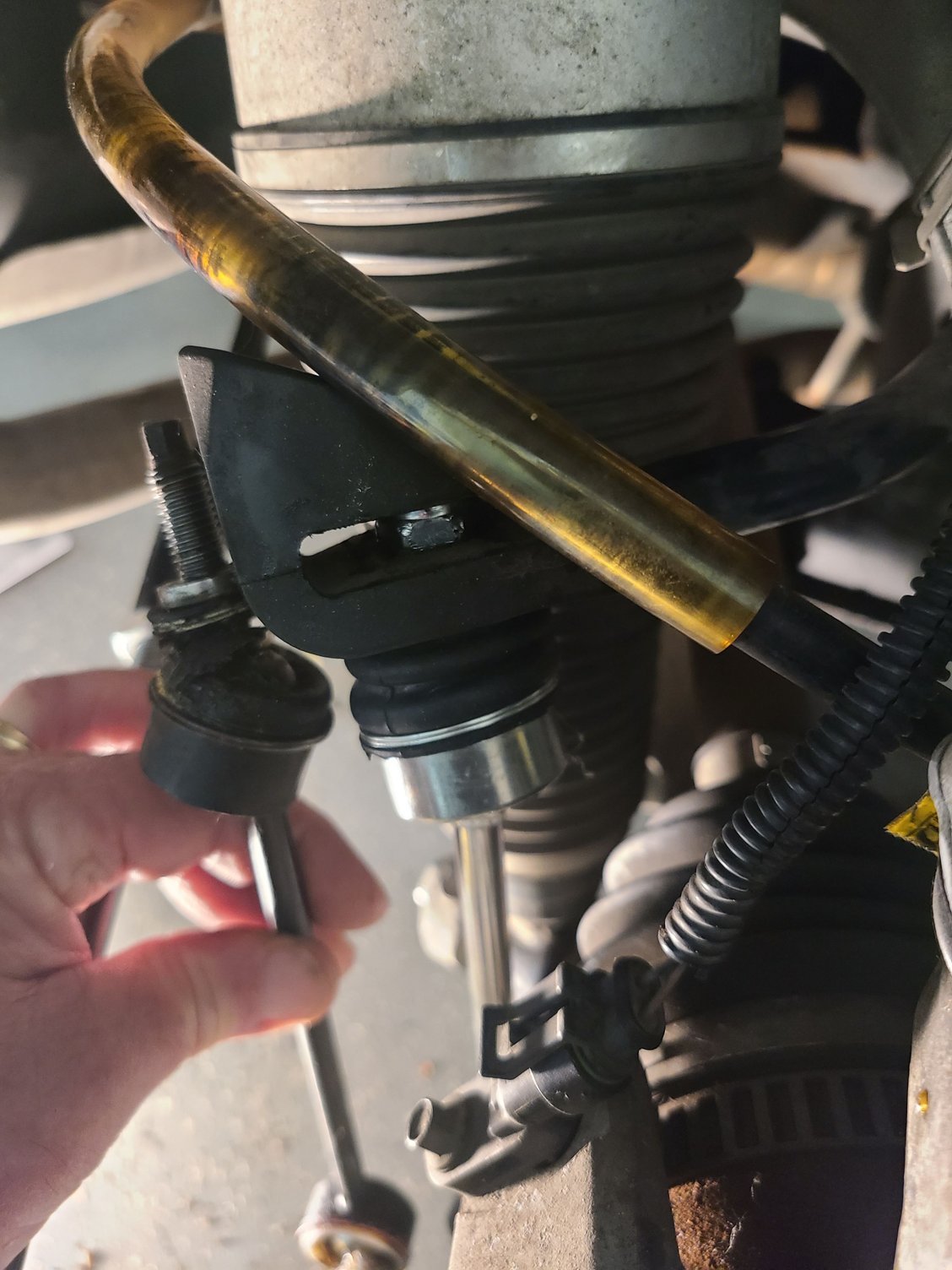

I have a 2004 XJ8 and I replaced all the bushings and links in the right rear today.
One part is concerning me.
The car only has 45,000 mi , so I don't think the linkage has ever been worked on.

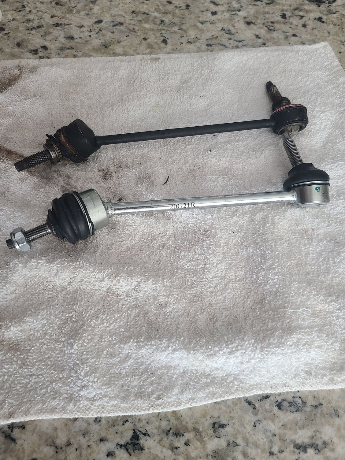

My aftermarket sway bar link is clearly labeled right, but the aftermarket left labeled linkage orientation is oriented as was the part which I took off the car. Did the factory switch sides or is the aftermarket part labeled incorrectly?
Frankly, the aftermarket part looks oriented correctly, and the what must be a factory part, which just came off the car, incorrectly. Just by common sense
I think the aftermarket part looks as if it is labeled correctly.
I hope that makes sense.
Can someone shed some light? I could order a Jaguar OEM right linkage to match up to my aftermarket, but that seems a waste of time and money.

Feb 20, 2022 | 04:32 PM
Installed new part labeled R on XJ8 350 series

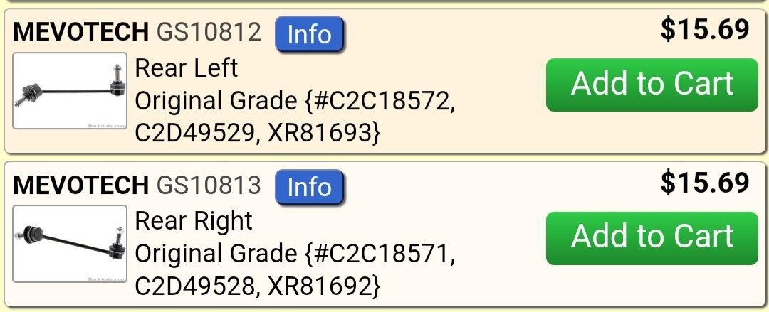

Feb 21, 2022 | 08:26 PM
My left and right aftermarket parts are different geometry.
from Rockauto

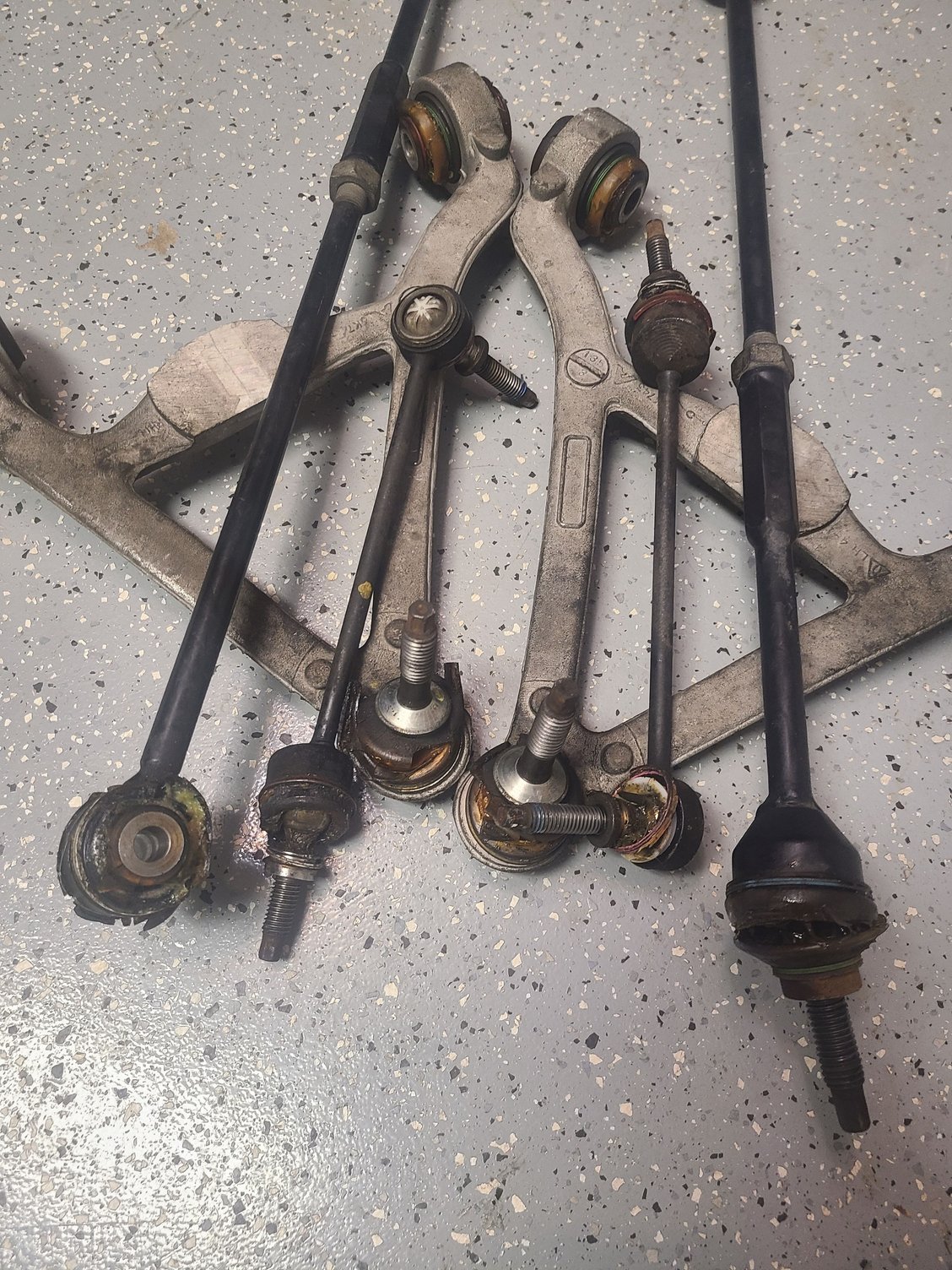

Everything replaced
I did not show the lower arms in the picture because they are back in the car. I purchased bushings off eBay and had three new bushings pressed in per side.
The parts I purchased through eBay seemed good quality. If you are careful how you shop, you can find everything at good savings, and again, seemed good quality. If you don't want to go to the trouble of pressing in new bushings, it really is a wash pressing in new bushings versus buying the whole arm with bushings. I am at least recycling a complex part.
