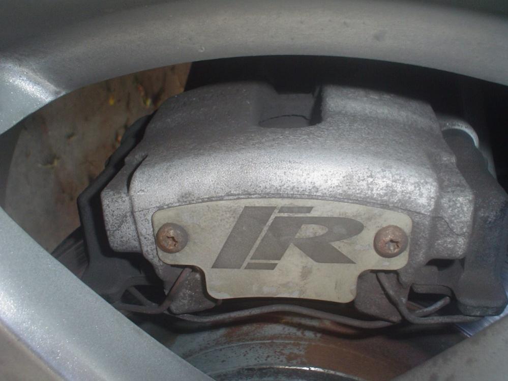

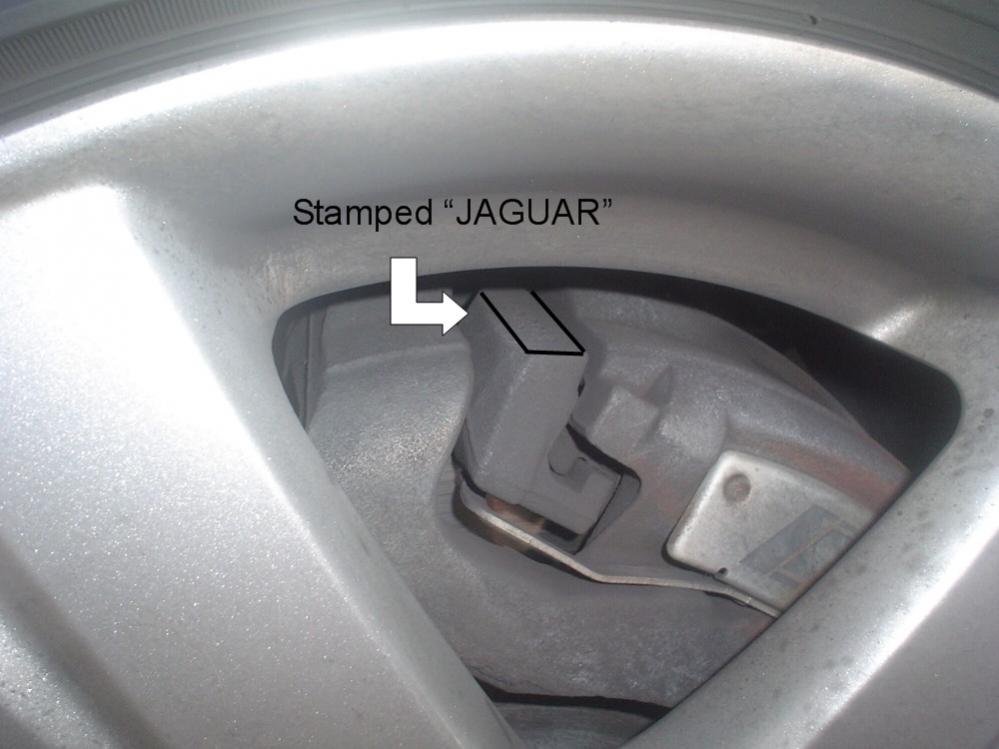

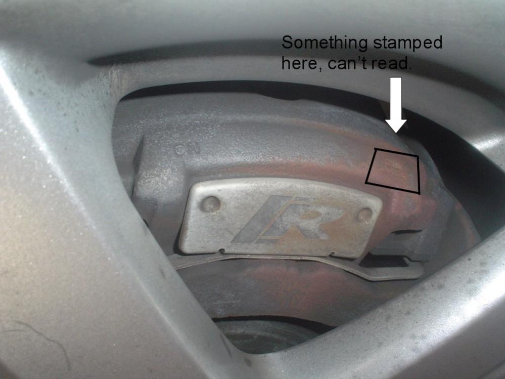

Left rear brake....
Next 2 are the Left Front....
Hope these help. Thanks

Those are not brembos
HERS A PIC OF BREMBOS
http://carphotos.cardomain.com/ride_...0007_large.jpg
