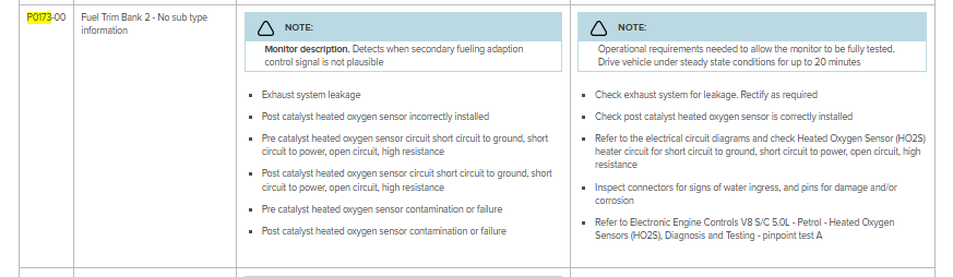

Update: AutoZone scanned it and returned a "P0173 fault in the Bank 2 Fuel Trim for a predetermined period of time."
My research suggests I don't drive it as it may severly damage the engine. I have a query into my dealer asking for advice.

P0173 is a generic OBD fault, your car may have more specific faults if scanned with an actual JLR tool. Which engine? The 4 cyl doesn't even show P0173 as an option in the PCM.
Assuming you have a V8, it looks like an O2 sensor is failing, but post-catalyst. Usually won't affect anything but emissions.
I wouldn't be afraid to drive it home like that.

I had exactly the same problem/code with my 2019 SVR. Bought the car last November, and during the 250 mile drive back home the CEL came on after stopping for a short break. Continued home and took it to the local JLR dealer next day who diagnosed it as P0173. Dealer thoroughly checked the fuel cap, vacuum system, MAF, O2 sensors, etc, but couldn't find any obvious fault so recommended I run 2 doses of Techron Fuel System Cleaner through 2 fill-ups to clean out the injectors, which I duly did. Following this I did a lot of short (max 40 mile) trips and the CEL stayed off, however on the next long road trip the CEL came back on after stopping for a short break following a 100+ mile run. Once again it threw up P0173 code. Long story short, both catalytic convertors had to be replaced (had to wait a month to get them from the UK), and now the CEL issue has finally been cured. I was initially terrified over what would have been a $9,000 bill for this job, but fortunately there is a USA federal mandate that states any manufacturer must replace CC's free of charge if the vehicle is less than 8 years old, so in the end it cost me nothing.

There's 8yr/80k mile warranty on emissions components, so even the O2 sensors at that point would also be covered. The SVR tends to cook the cats due to the aggressive overrun popping, it dumps too much fuel and hurts them in the long run.
