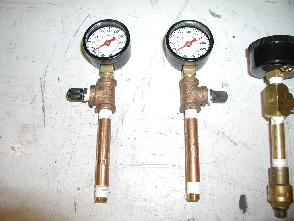

Originally Posted by Brutal
Well with all the air spring question and how to diag questions that come up not only here, but shops cant seem to get it right either.
I made individual test and air fitting with gauges. You screw them (if you make 4) in the air spring tops after you remove the air line. Then you fill them up with compressed air with an air chuck just like you fill a tire. I take them up to 100-125 psi and then watch to see if they go down. You have to make sure that they dont leak in the top where they screw in. use a bubble solution to check and teflon tape. I built these with brass fittings 1/8" pipe thread, gauges, and screw in schraeder valves, all sealed with teflon. The front takes a plain 1/8" pipe thread into the fronts, and the fittings you see on the second set are actually the front spring fitting taken out and these screw into the rear ports that have different thread sizes. This takes almost all the guess work out of determining how many of your air springs are leaking and how fast. The Jaguar way can even lead to misdiagnosis cause you measure height of each wheel arch to the ground. 1 air spring dropping will also pull down and lower the rest of the car front or rear. SO you dont know if that corner is leaking too, just less, or not at all. Ive thought about making more and selling, but I dont know they can be alittle pricey and a hassle to get all the parts and ship but who knows. If I get enough request I might. Another note is that Ive never ever seen lines leaking. Always air springs or new compressors that people didnt pay attantion to the air line fitting and proper sealing. 99% are always the air spring and predominatly behind the bellows where the lower seal seals against the shock body.
Still a great idea!!!!
Attached Thumbnails Diy air spring leak diagnosis-p1010082.jpg   Diy air spring leak diagnosis-p1010084.jpg

Brutal:
that was an excellent idea, you came up with, did you have to buy the pipe, air gauge, etc..., all from one supplier, or different ones, I'm thinking of starting with the front, two setups, I take it the front thread is 1/8" npt, but the back thread is not npt, and if its not , then is it standard or metric, much appreciated since you already did all the hard work.

brutal,
when you have a chance It would be much helpful if you give me some specs about the thread kind, I mean the front is 1/8" , but there is npt and bsp type,and also what did you have to reduce for the shraeder in the 1/8" tee. I see you put a reducer there, also what type of the thread is the shraeder.
Your response is much appreciated!
