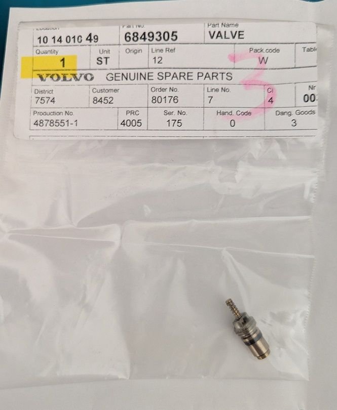

Unfortunately, that Volvo part is not correct (at least for my '04 VDP) see the attached photo of the Volvo valve on left, and the old valve on the right..
There is a service kit #26782 available at O'Reilly, Amazon, etc. that has one valve that does work.

I'm so sorry--I didn't expect that Jag changed any of the a/c parts between years. The Volvo schrader on the left in your picture is definitely what's in my '06.
No worries, you were only trying to help, and it is appreciated. Just wanted anyone finding the thread to know it isn't that straight forward.
