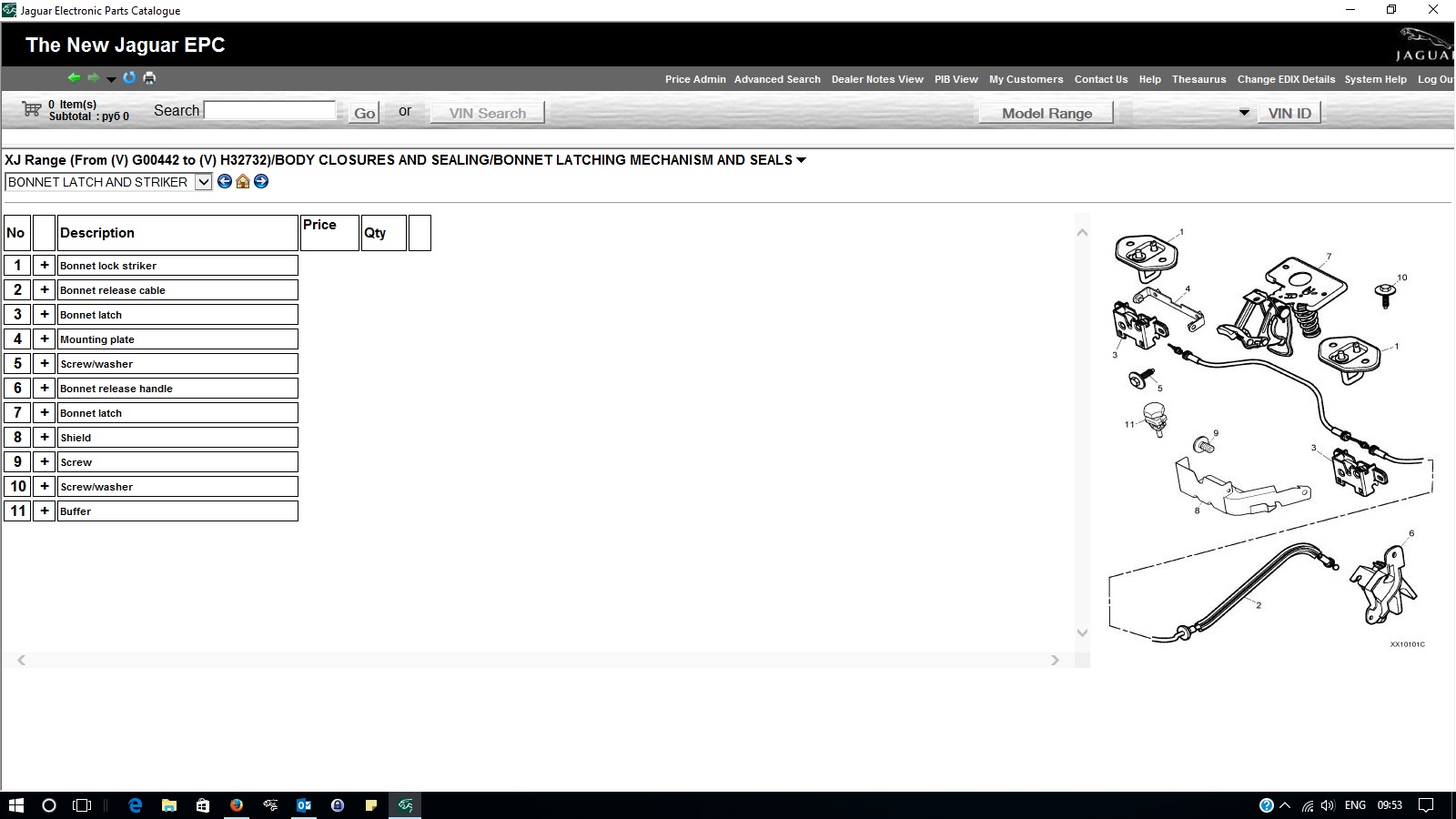

The release mechanism is mechanical with 'bowden' cable connecting the Latches (item 3) to the Release Handle (item 6):
Does battery need to be connected to release hood latch-x350-bonnet-release.jpg
The battery needs to be connected for the 'open' warning to function.
