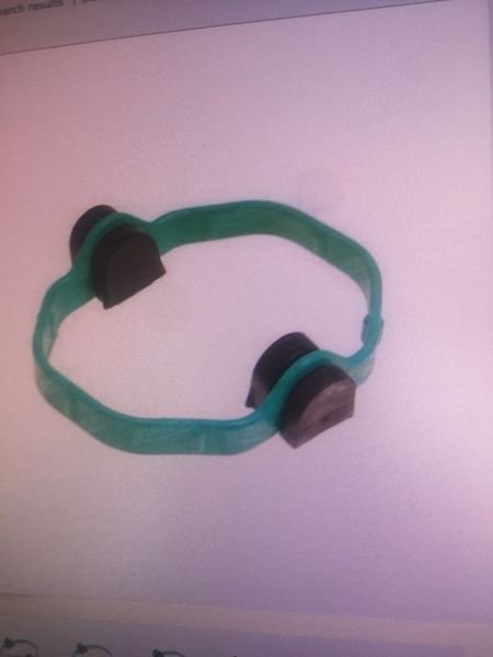

2004 Vanden Plas
The mechanic can't find this part pictured below. He has the engine open and needs to replace it but he says the dealer will only sell the whole intake manifold and not just this part. But the mechanic doesn't know what the part number is. Any idea how I can find out so I can order the part?
Thanks for your help.

This looks a lot like what you want
jaguar xj8 s air intake manifold to adapter plate upper gasket reseal kit 2003- | eBay

Thanks, that was super-close but not compatible, unfortunately.

Found it here Jaguar SEALS FOR INTAKE PLENUM TO LOWER INTAKE MANIFOLD SET OF 8 - PLENUMSEAL-KIT
Thanks for your help!
