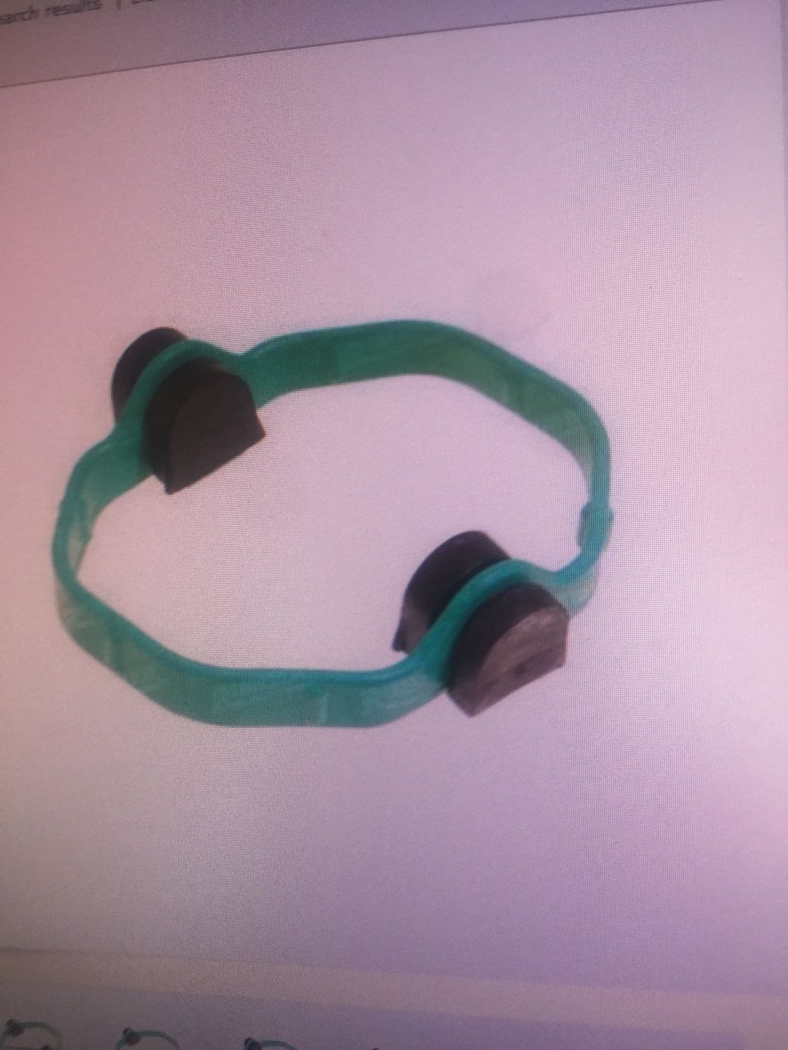

I am having the gaskets replaced on the manifold by a mechanic, however the mechanic is saying he can't get this part called the "Lower Plenum Gasket." I have found a place called partsgeek.com and they seem to have a lot of parts but not this one. The mechanic can't give me a part number for some reason.
Here is the picture he gave me:
Lower Plenum Gasket
Any idea what this part number is and where I can find it?
Thank you in advance.

Wrong forum or not the parts are available from JAGBITS one of the forum sponsors.
SEALS FOR INTAKE PLENUM TO LOWER INTAKE MANIFOLD SET OF 8
Part #: PLENUMSEAL-KIT
SEALS (GASKETS) UPPER INTAKE PLENUM TO LOWER INTAKE MANIFOLD SET OF 8 OEM SEALS FITS 2004-2009 XJ8 AND 2003-2008 4.2 S-TYPE

Yes thanks for the referral AVERN1 Jagbits has them in stock use the forum discount coupon code JAGFORUMS-10% when checking out:
Jaguar SEALS FOR INTAKE PLENUM TO LOWER INTAKE MANIFOLD SET OF 8 - PLENUMSEAL-KIT

Picked up my car yesterday and the part was perfect. Thanks again Gary and Vern!
