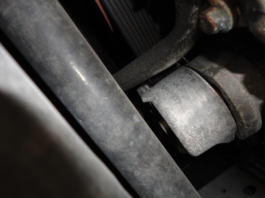

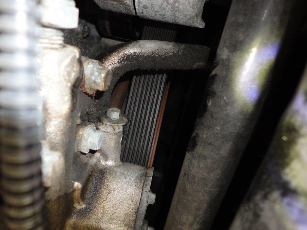

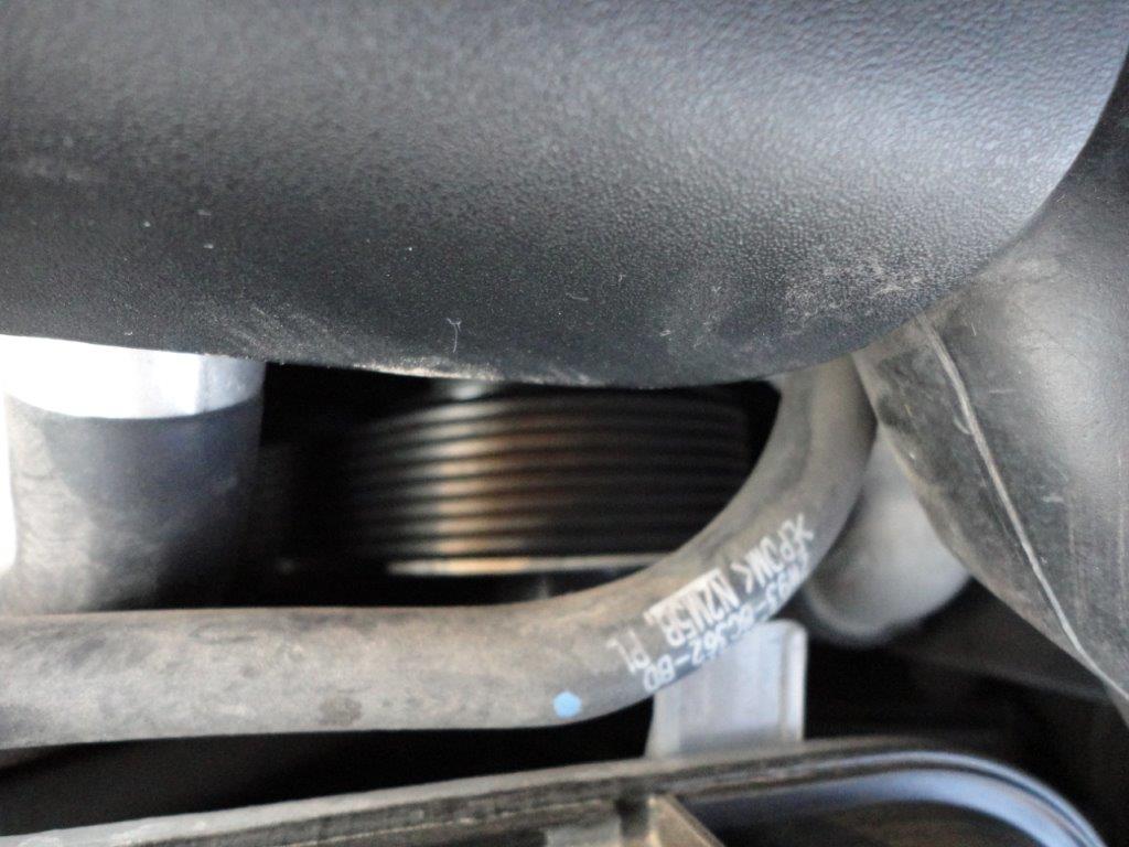

With 140,000 miles on the car I just bought, I thought that I would collect some spares like coolant hoses and belts. Parts house asked if the car had a changed supercharger pulley and belt tensioner as cars with that upgrade use a different belt.
The belt in my car has grooves on both sides as seen in the photos. I was not able to find the part number on the tensioner, but the tensioner is also grooved.
I have attached a few photos. The belt is in good condition with no cracks, so I am thinking it is fairly new.
Is this stock?

The early ones had a single sided belt, but this was changed to a double sided to reduce squeal. Might be C2C37063

Up grade kit from jag the belt come in a kit with new tensioner and idler to stop the squealing on first start up

When I had the squeak, I changed to gator Diamond back and never had issues since

The part number for the double sided belt is C2C37055.
