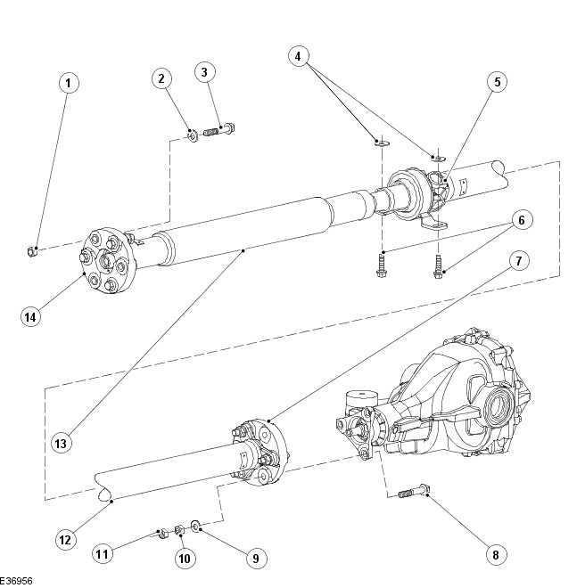

It says that the driveshaft must be replaced as a whole unit. At least this way the donuts at the ends will get replaced as well. Does this vibration get worse as you drive, or only at idle?
2003.50 XJ Range (X350), 205-01
Driveshaft
DESCRIPTION AND OPERATION
Loading...
ItemDescription1Transmission flexible joint retaining nut2Transmission flexible joint washer3Transmission flexible joint retaining bolt4Centre bearing spacers5Universal joint6Centre bearing retaining bolts7Rear drive axle flexible joint8Rear drive axle flexible joint retaining bolt9Rear drive axle flexible joint washer10Rear drive axle flexible joint retaining nut11Rear drive axle flexible joint balance nut12Rear driveshaft tube13Collapsible front driveshaft tube14Transmission flexible joint
CAUTION:
To preserve 'drive line' refinement, individual parts, other than fixings, MUST NOT be renewed. In the event of any balance or driveshaft component related concern, the complete assembly must be renewed. Under no circumstances may the flexible coupling be removed from the driveshaft (or its fixings be loosened). Do not drop or subject the driveshaft to damage.
NOTE:
All driveshaft assemblies are balanced. If undercoating the vehicle, protect the driveshaft, universal joints and the rear drive axle shafts to prevent over-spray of the undercoating material.
The driveshaft consists of the following:
  • A two piece welded steel tube with a splined center slip joint.
  • A universal joint.
  • A center bearing.
  • Two flexible joints.
Universal Joint
The universal joint is:
  • a lubed-for-life design and requires no lubrication in service.
