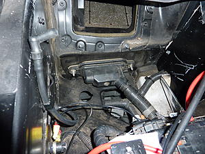

Is this my ECU socket/plug?
It is held in place by two 10mm nuts.
Will not pull out with reasonable force.

That is the electrical connector for what Jaguar calls the Engine Control Module (ECM). The ECM is on the other side of the firewall behind the glove box, and those two long screws can be removed from that side. The connector is secured to the ECM by a screw in the hole visible in the center of the connector in your photo. To disconnect the connector requires a 5-lobe tamper-proof Torx bit with a hole in the center. I bought a set on eBay for under $20 that looks like this:
