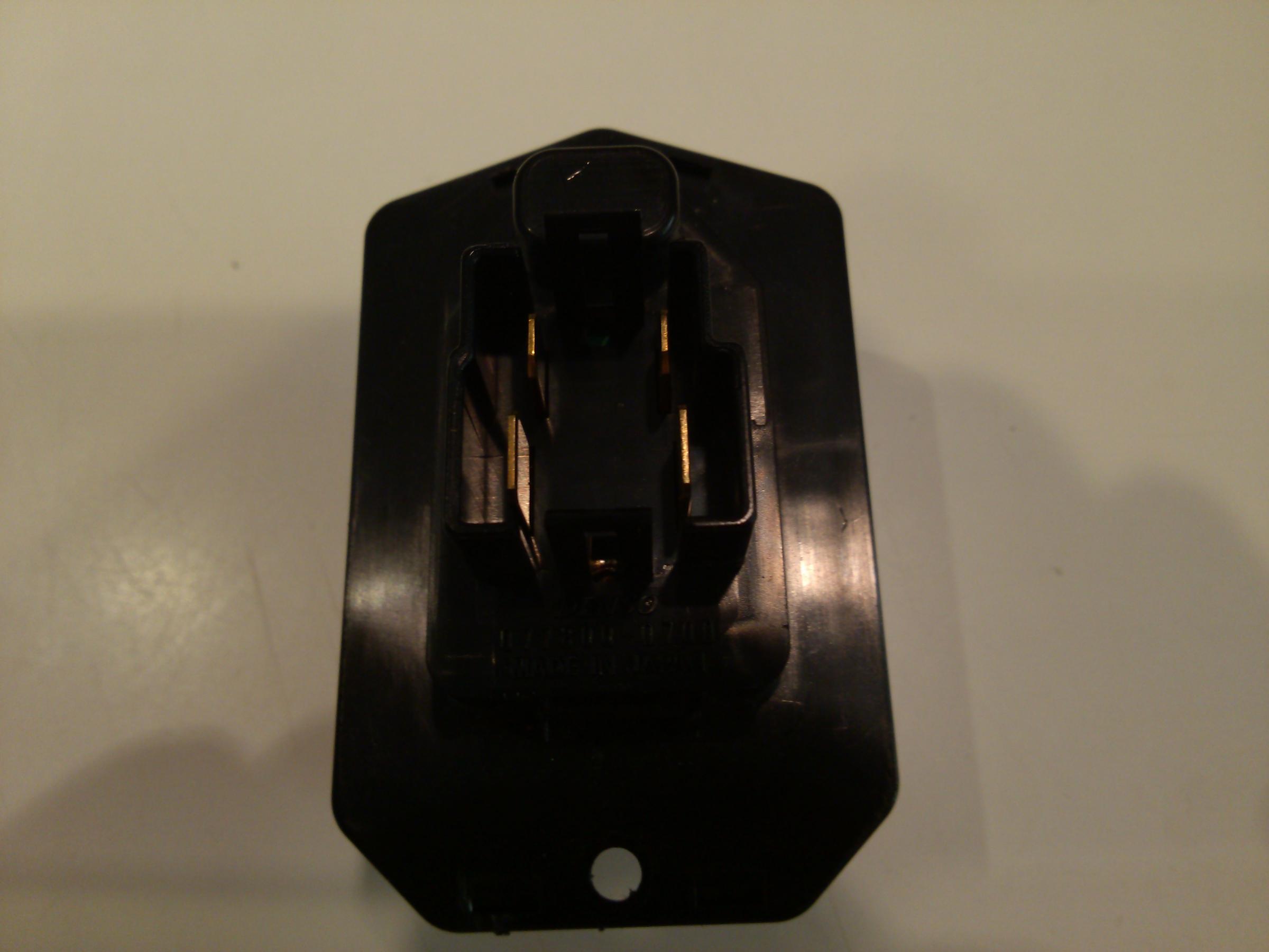

Many thanks to everyone for helping me remove the glove box in my 2004 XJR. It has allowed me to remove what I think & hope is the Fan Control Module. Thought I would post these pictures and ask if this is the right part. In my car the part is: DENSO 077800-0700 Made in Japan.
Also, it was not readily apparent to me where & how to test the actual fan. Any help on this would also be greatly appreciated. I trust it is the module, but just in case...
Thanks again for all of your help getting me to this point.

Yes that is it! If all the indications are that the blower is running but it is not
running then it will be the speed control module.
It is a very common fault on this Jag-I wouldn't worry about testing the fan.
Once you have replaced the module you can try it prior to refitting the glove box.
I repaired mine but then I'm tight!

It works! It works!! Thank you! Now, just to get the glovebox back on!!
