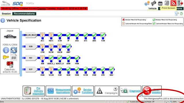

Trosty,
I thought you had a Pro model; see your screenshot

Originally Posted by hafren
Trosty,
Attachment 117271
No I have the cheapo Sp116 version, The pro version is SP205 (however I can't see or tell what the differences are!!). I expect the version on the print screen comes from the mongoose JLR windows driver set. Both the pro and non-pro version use the same windows drivers.

I bought from the same supplier albeit earlier & it came with SDD 138. Mine was just the regular mongoose but it wont recognize/use the original mongoose drivers only the pro drivers, they are different. I also looked at the images on their website and the QC numbers shown for SP 116 are QC31114-006 and the Pro versions SP 205/205b are QC41226-002. My QC number is QC40923-002.
While I cannot be sure I have the strong suspicion that they delivered a Pro version even though they list it as a regular. My 2 cents.
