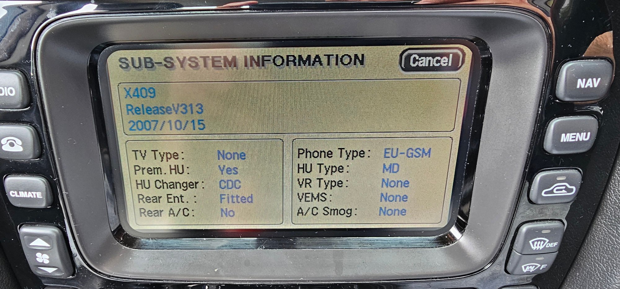

CD Changer not working. Showing as not fitted. I've enabled it in dealer options and on the Audio Module on SDD.
When I access the hidden menu I can enable it, but when the car is turned off it disables it again. CD Changer not recognised at all. It gets power ok and all wires are connected.
Audio Module was taken from an X Type as per this picture. It won't reflash. I also dont have rear entertainment. I keep disabling it, it keeps reappearing in the menu intermittently.
