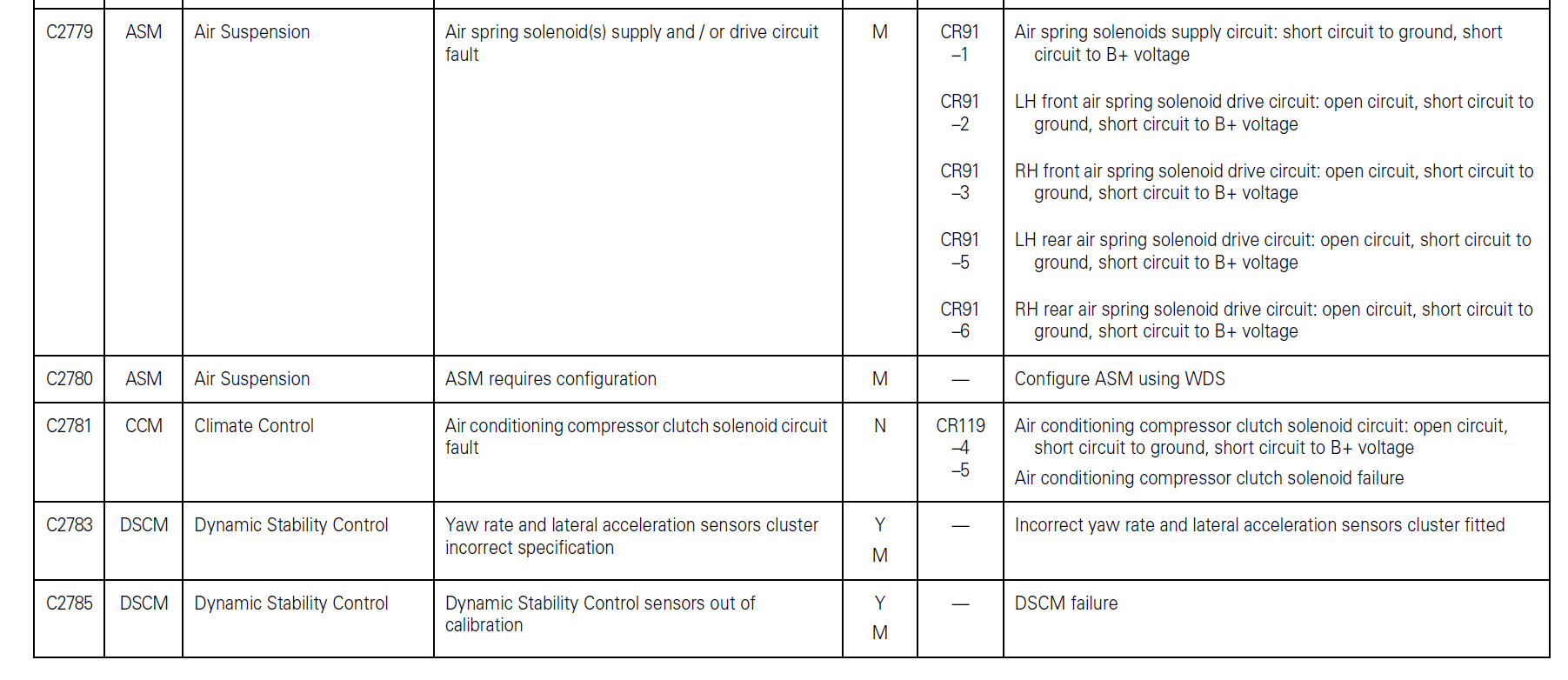

C2780 ?
C2780
Control module in manufacturer sub-state
  • Control module programming
Programme the control module using the Jaguar approved diagnostic system.

Yes 2780 code I think. And it does have 4 sensors and all are fixed and reading correctly.

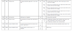

Yep, if that's the code, then you'll need someone with SDD to program ASM
Attached Thumbnails Front air problem/strange code-04xjasm.png
