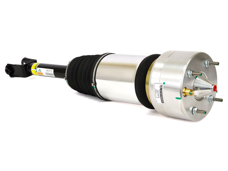

Thanks for your reply, I did a little test yesterday afternoon. after viewing some YOU TUBE videos on suspension issues on these Jags, I started the car, and sprayed some soapy water on the air line that screws to the top of the Bilstein strut, this is found in the engine bay , one on each side. To my surprise the passenger side had some bubbles appearing from the brass bolt that screws the hose onto the nipple from the strut. I attached a picture of the strut. I am talking about the brass connecter on the upper part.
What should I do now?
Attached Thumbnails Front end sagging overnight 2005 Super V8-2710-lrg-02%5B1%5D.jpg

My first response was it's normal since mine does the same thing in cold climates or if it sits for weeks without starting. Then I read on and saw you found a leak.
Keep us posted on if there is a fix or if you have to replace that shock/strut.
Have a look at this thread https://www.jaguarforums.com/forum/x...roblem-110808/
