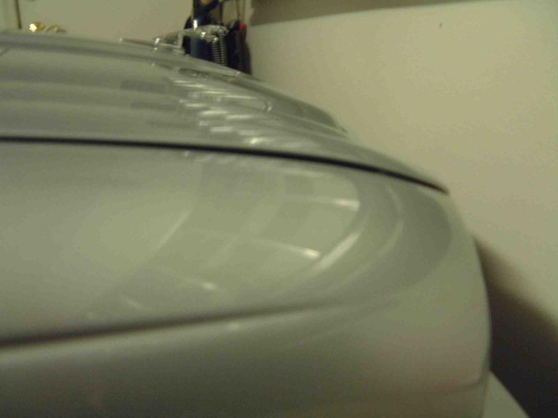

I have just finished a 5,500 mile road trip with no mechanical or electrical problems in my 2006 XJ8L, however I now notice that the front of the hood on the right hand side in not flush with the fender. It was 8 mm higher while the left side front hood is about 2mm higher than the fender. (see pic)
On the RHS I tried lowering the bump stop (top left in pic and bottom right) more than the 5.5MM and I also reduced the height of the Right hand hood latch bracket (see pic) it had an adjustment nut - figured that this hood latch bracket is gripped and drawn down by the locking mechanism into which it locates when the hood is closed.
However, these adjustment only made a slight improvement and the RHS of the hood is still proud by approx. 5.5 mm. When I push down on the front right corner of the hood it moves down, so at high speed the wind gets under the lip of the hood and can buffet in the wind.
Has anyone had a similar problem? Is there a cure?
What are the hood adjustments available?
Any input would be gratefully received.
Steve
Attached Thumbnails Front hood not flush-front-rhs-hood-alignment.jpg   Front hood not flush-bump-stops-rhs.jpg   Front hood not flush-hood-latch-bracket.jpg

Default this is how you do it
there is a bolt and head with rubber cushion at the leading edge of hood on both front far corners..(this you show on your own middle pic..they are on the lower body and not the hood), each can be adjusted independently to level up or down by7 turning the thread, it is not a big deal.

Default fixed it!
I checked both Carfax and my close inspection and no accident damage.
However with a bit more tinkering I fixed it.
If you look at the third pic in my original post, the right hand hood bracket that locates in a gripping mechanism in the car body when closed. This I had assumed (wrongly) that if I reduced the distance between the bottom of the bracket and the underside of the hood, then the hood would be pulled further down when closed (I reduced the depth of the bracket to 34mm from underside of hood to bottom of the bracket). It seems this had the effect that the mechanism gripping the bracket could not "get hold of it" so was not gripping and pulling the hood down on the problem right hand side. Thus when I extended the bracket using the adjustment nut back to approx 43mm (from underside of hood to bottom of the bracket) the mechanism could grip the bracket and pull the hood down.
So problem solved and hood now flush and even both sides of the hood. Obviously the bump stops (bolts with rubber cushions) both at the edge of the hood and the second one further to the center of the car have to be adjusted just so.

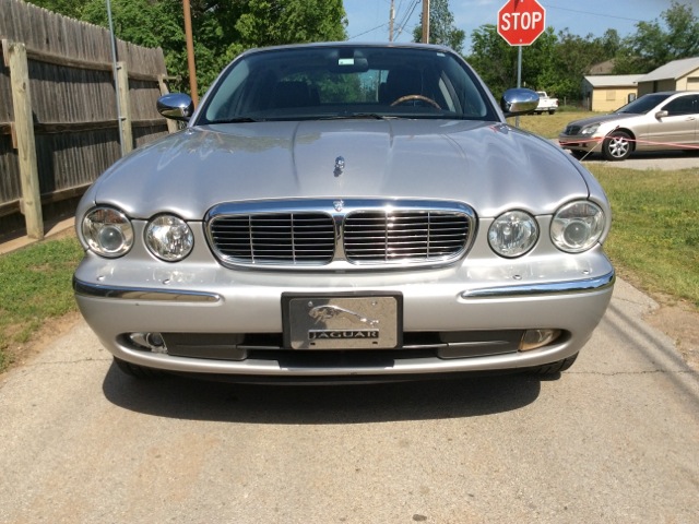

Thank you guys for this post. We just became Jaguar owners for the first time yesterday and I can tell this forum is going to be a lifesaver! After much adjusting the bump stops and latches on the hood/bonnet to no avail I finally figured out that my problem was that the passenger side latch wasn't latching. It doesn't appear to have been properly lubricated for a while so I worked in some white lithium grease and now it's good to go!
I don't have an after pic yet but this is a picture from the car's sale listing where I could see the problem originally.
