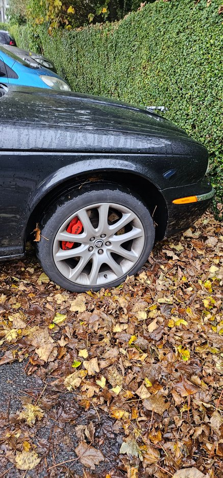

Seems my 2004 XJR has decided that now is the time for the suspension to start malfunctioning. Car is rigid as hell. Front suspension seems to be at max height.
I have SDD but I'm scared to use it to recalibrate incase there is a failure with something else. Can anyone advise?
Rears seem fine. The compressor does release pressure when I park up in the driveway, can hear the hiss as it depressurises, so I assume the exhaust valve isn't blocked.
