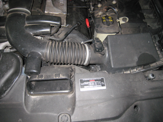

Originally Posted by Mikey
I don't believe adding heated air would solve the problem. The supercharger is already doing that while under boost. If we use the explanation given by the Minnesota dealer that ice is forming at the outlet, combined with the analogies of wings, windows and ice water, more hot air should produce more ice.
Instead of 'more heat', I'd suggest again 'less cold'. If we accept the first dealer's explanation of condensation in the IC, then it makes sense to reduce the cooling effect it has on the supercharged air.
The Minnesota service rep said that it only happens when it is really, really cold. The way I understood his explanation, it was because the air temp is so cold coming into the s/c, it was frosting on the rotors.
Anyway, I decided to remove the intake snout and allow the air to be sucked in from behind the radiator (see photos). The temps aren't supposed to get in the single digits any time soon, so hopefully I won't have to deal with this for awhile.

I'm not sure frost would form on a spinning rotor...but where ever it is forming in the intake your new "mod" should help. Be sure to update us if the temps turn cold again!

I can't imagine it either. If it froze before any work was done by the S/C- all cars would have frosted intakes.
