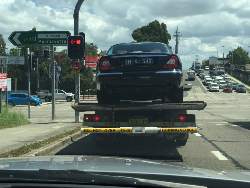

I've decided to bet on bad fuel, and am getting the car towed to the local Jag dealer service department.
The service advisor said "oh yeah, we see it now & then, still got the receipt for the fuel? the petrol supplier will pay"
At the very least they will be able to get the panel off the underside that hides the fuel filter, two of the captive bolts are spinning & i can't get the nuts off...
Sounds like a good plan. We'll all be anxiously awaiting the outcome.
