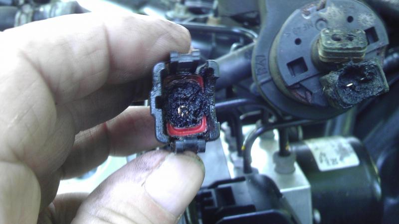

Florida. I crossed the Georgia line going north and picked up the smell of what I thought was a pulp mill. It may have been, but it didn't last that long. CEL lite up and the pesky low power advisory set again. I pulled over waited a few seconds and restarted the car, the advisory reset and off I went with a CEL lite. Fast forward a few hours I get home and roll into Auto Zone to find a P2601 code auxiliary coolant pump. Pin point trouble shooting guide says to look for voltage ........ I ordeded a pump before I got into it. Good thing I did the connector, wire and pump were fried.
After I got things removed to get @ the pump I saw that only one screw was holding the pump tight, so I recon someone had already looked into this and decided not to replace the pump. I'll hit the dealer for the connector on Tuesday. Quite a bit of plastic is broken under the hood as well. I guess some hack with a hammer was working on it. Jeez.

I really don't think all of the damage happened @ once.... you would think a fuse should have given up first.
Ouch, that connector has really had some amps through it, hasn't it !!

Fast forward a few days and trip to the dealer to no avail I took the burnt out shell of the connector and made new pins and filled it with hot glue and a 5 minute epoxy. The connect has lost its self retention feature so I used tie wraps @ the base of the connect to retain it all is well in that aspect.
I wanted to get to the bottom of what happened so I looked @ the number 8 fuse in the trunk. I found a 15 amp in place of a 10 that had gotten very hot and blistered the fuse. The element was so distorted I was amazed it still had continuity. No damage to the fuse box or socket as far as I can tell. I checked for voltage @ that the fuse and found 2 volts +/- of a few tenths after I replaced it with a 10 amp. I thought that was a bit unusual so I checked @ the pump same voltage. The rear climate controls are locked out from up front so that maybe correct. I didn't have time to explore that.
