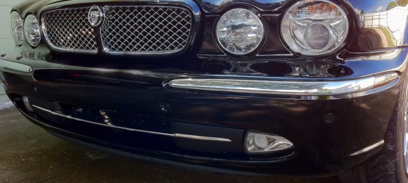

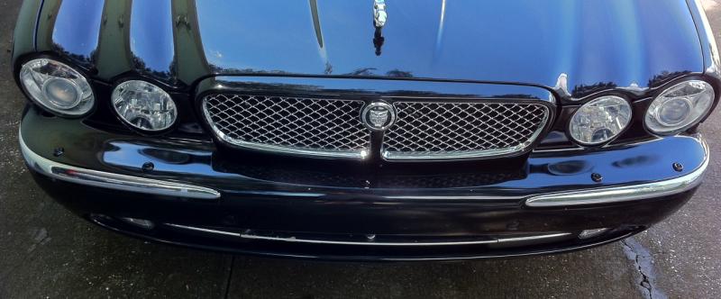

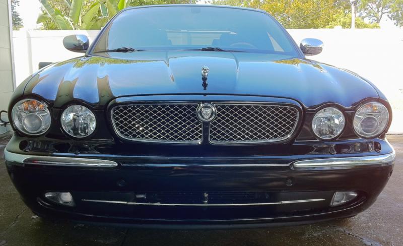

Finally got around to getting some of the pics posted of the aero blade on the bumper chromed. Unfortunately Spectra Chrome had some issues and I am awaiting them to re-chrome the parts.
The results I thing are awesome. Tell me that you think.

I like it. It's a subtle improvement.

May I ask where you purchased all of the aftermarket pieces?

Looking good! nice mod.

AS I mentioned before, I had the original pieces chromed, nothing aftermarket here. There are some minor flaws and when Spectra Chrome re-chromes them, I will take better photos.
However I may find myself selling them, as there appears to be an issue with the radar based Foward Alert and Adaptive Cruise Control interacting with the metal in the chrome, and buying new ones from the dealership :/ We'll see...

Update: So it turns out the chrome indeed affects ACC and forward alert (not park distance control as these are separate sensors). So looks like I am going to put these up for sale to anyone who would like to spiff up their jag as long as you do not have the above mentioned option.
