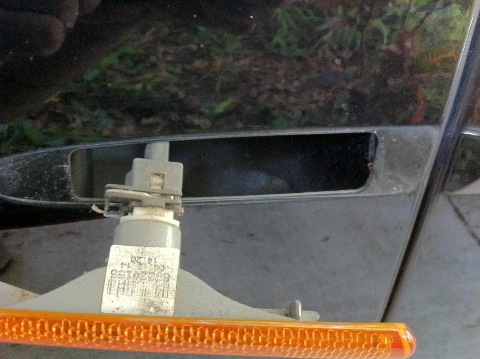

Did anybody ever figure out if the '06-'07 style lights will fit on the '04-'05 without modification?
Old Jun 21, 2011 | 06:40 PM
jahummer's Avatar
Joined: Dec 2008
Posts: 6,460
Likes: 2,583
I wonder if you could just glue the 2006-2007 side repeaters on and have it look half decent (maybe it covers up all the holes)?
Looks like it will not work, the cut out hole is almost as large as the repeater assemblies. See pic below. By the way, they pop right off by pushing on them from back to front.
