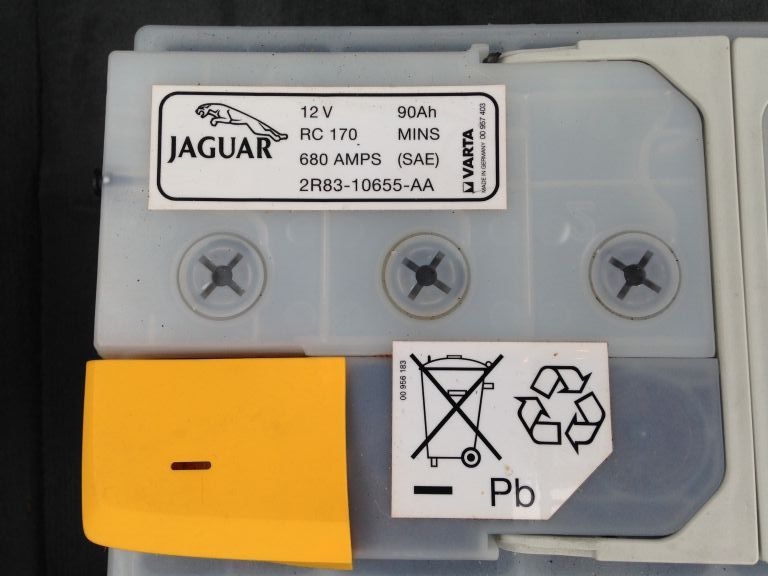

I went to Autozone and had a load test done and it showed 12.7V and 31% Capacity so I bought a new one. Here are pictures of the old one, so if anyone can see the date of manufacture from the info contained, please pipe up.
Total cost $160 (with old battery rebate of $15).
The vehicle started first time and I carried out the new battery start up procedure mentioned in a previous thread about battery charging. Everything works perfectly now.
Attached Thumbnails I had to make a comment on batteries and then this!!!-img_0859.jpg   I had to make a comment on batteries and then this!!!-img_0860.jpg   I had to make a comment on batteries and then this!!!-img_0861.jpg   I had to make a comment on batteries and then this!!!-img_0862.jpg

If it's a VARTA (Jag OEM) it's stamped into the top of one of the terminal posts ... which are underneath the yellow flaps.
Ha, typical. I put the new covers on the old battery for transportation. Well we shall never know the year of manufacture then.

well I expect to be making a battery purchase soon as well. My battery on my 2004 XJR appears exactly as the photo above, but an opaque cover on the positive terminal on none on the negative terminal. I looked for a date stamp on the terminals but could not find one any other clues? My car appears to run just fine, but if the battery is years old its overdue to fail, and winter is coming! good part is the car is driven regularly, but less in the winter. Most American car batteries would be gone after 5 years.
