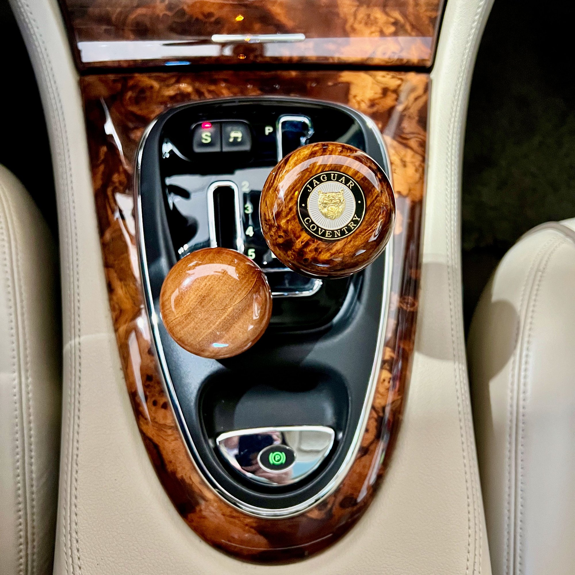

I recently purchased a shift knob from a shop on Etsy called BritishCarWoodwork. I am very pleased with the craftsmanship and I really like the Coventry logo. It also matches my woodwork better than the original as you can see in the picture. He has several options available with and without logos in various woods. This is the link to the shop. He sometimes closes for a week or so to catch up with orders as I believe he is a one man show. https://www.etsy.com/shop/BritishCar...?ref=shop_sugg

Thats a stunning gear knob!

Very nice shifting knob, do they just unscrew?
One of mine is cracked, but am hesitant to try twisting it very hard.
A broken shifter knob, would be much worse than a cracked one

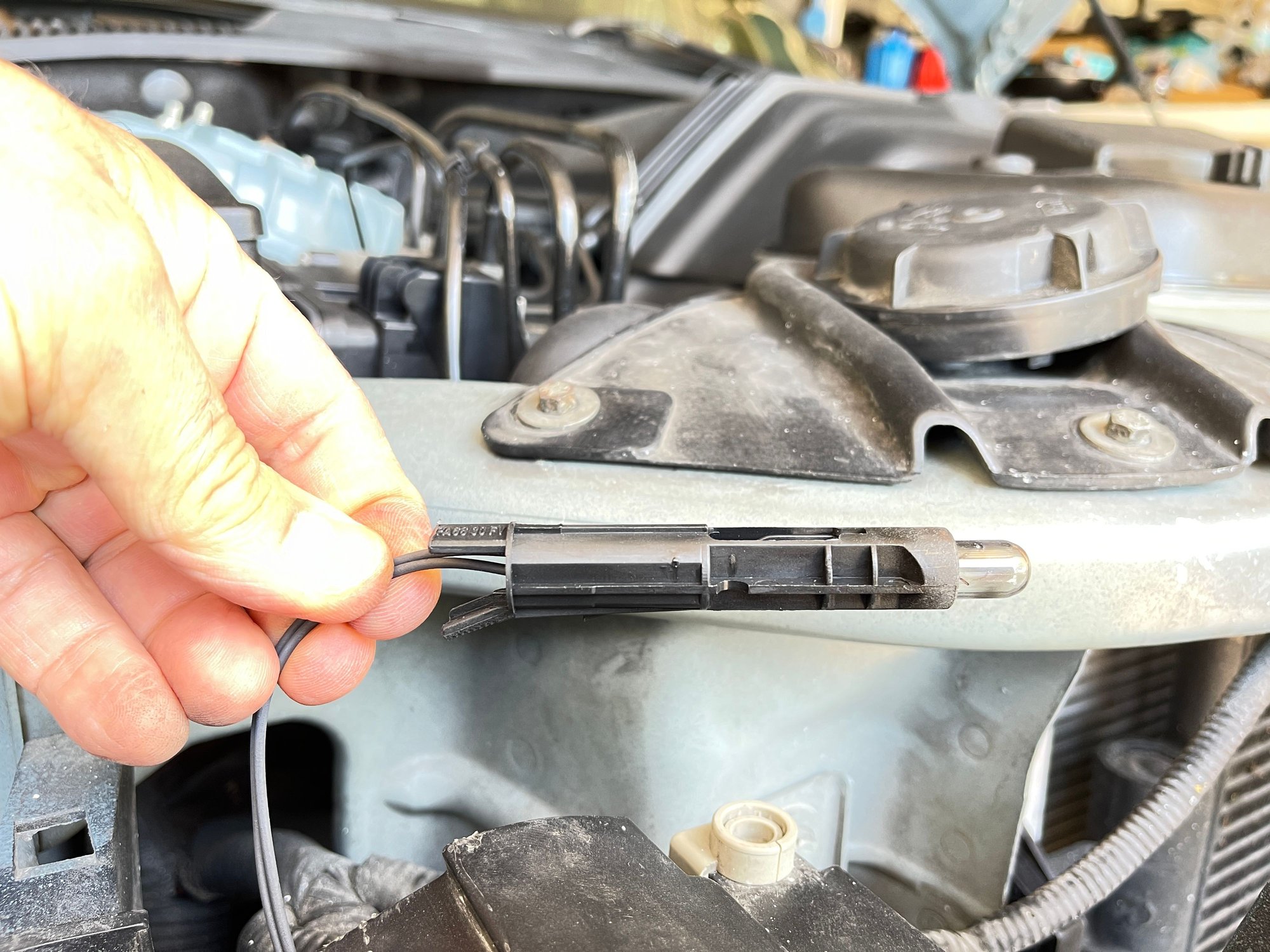

Anyway Jinxie will receive some grooming tomorrow, I'll try to change a parking light, whoever designed these headlight units deserves some punishment in after life.
I take that last sentence back. Changing the bulbs is a breeze as soon as you understand how the socket plug works. You just have to squeezed the upper part and pull out the socket.
Just push up the lower part and pull.
New LED bulbs.

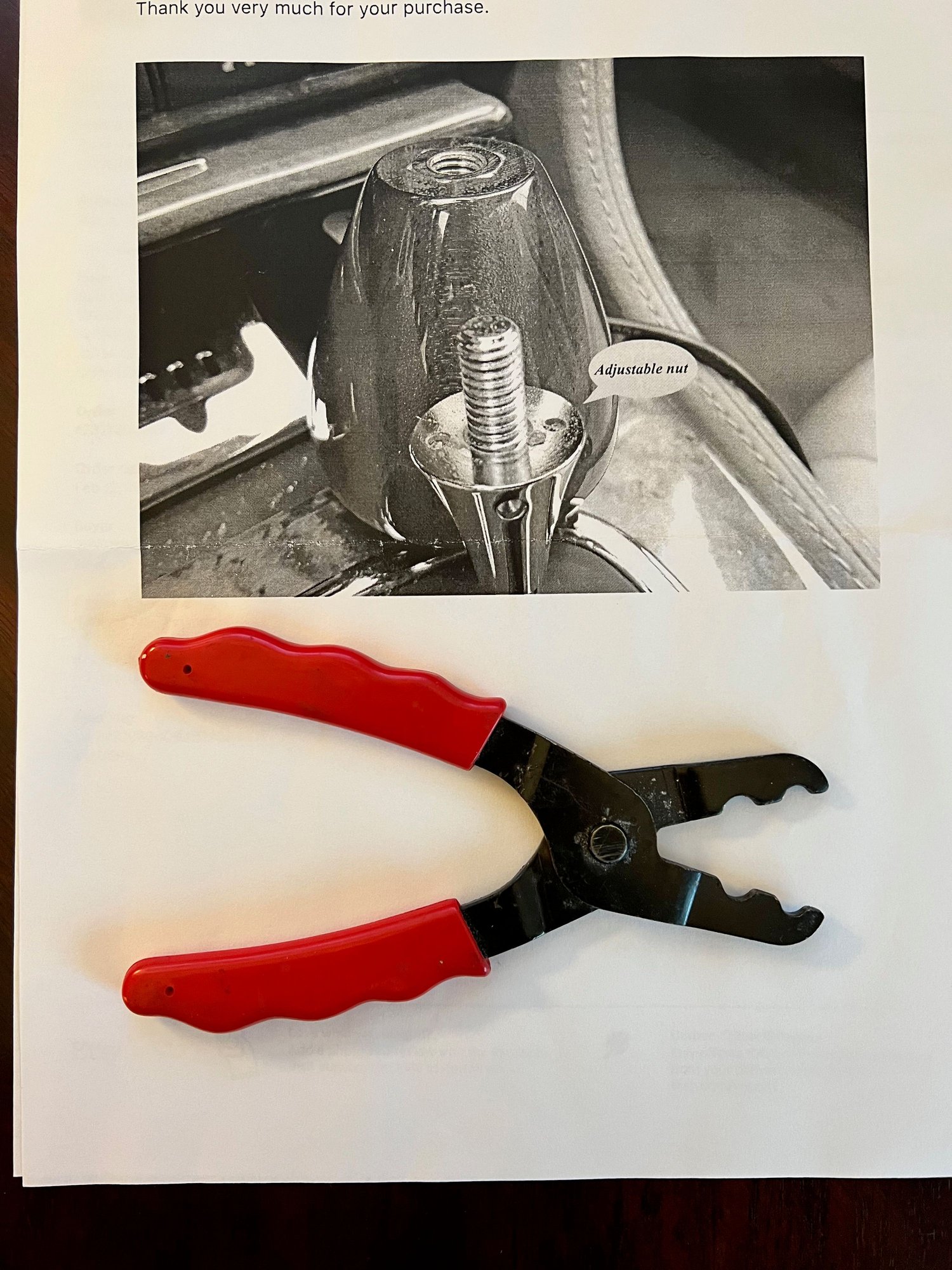

Yes, it just unscrews. You have to hold the metal portion steady below the knob to unscrew it. The pliers in the picture lined up with the holes and enabled me to loosen the knob.

That knob is beautiful, may I please ask what the diameter of the 'JAGUAR COVENTRY' badge insert. I would like to make my own knob from a burl I have and the badge just finishes it off very nicely. Hopefully I can purchase one from the seller.

Sorry for the Delay Bob, I was away from the car. I measured the badge insert and it is 1 inch in diameter.

I bought this very same knob from him many years ago. It was beautiful. If you request it, he may be able to add a bit more weight to the knob to give it a more hefty feel, if that floats your boat.

Thanks Jetset68, I had guessed the badge was around 25mm and you have confirmed this for me.
