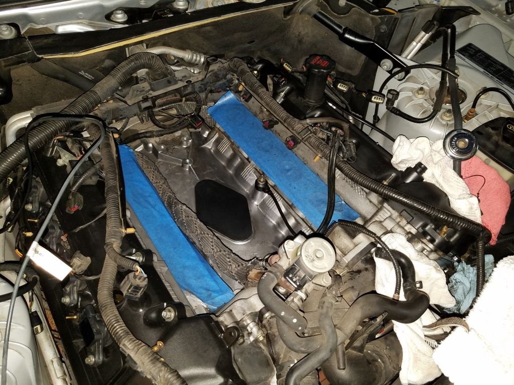

Regarding original question: I used Manifold Gaskets part number AJ89062. To make sure I'm referring to talking about the relevant parts - these are thin steel gaskets that clip on the bottom of the intake manifold and seal the areas where the blue tape is shown.
Intake manifold removed to replace valley hose
HTH, Dave
