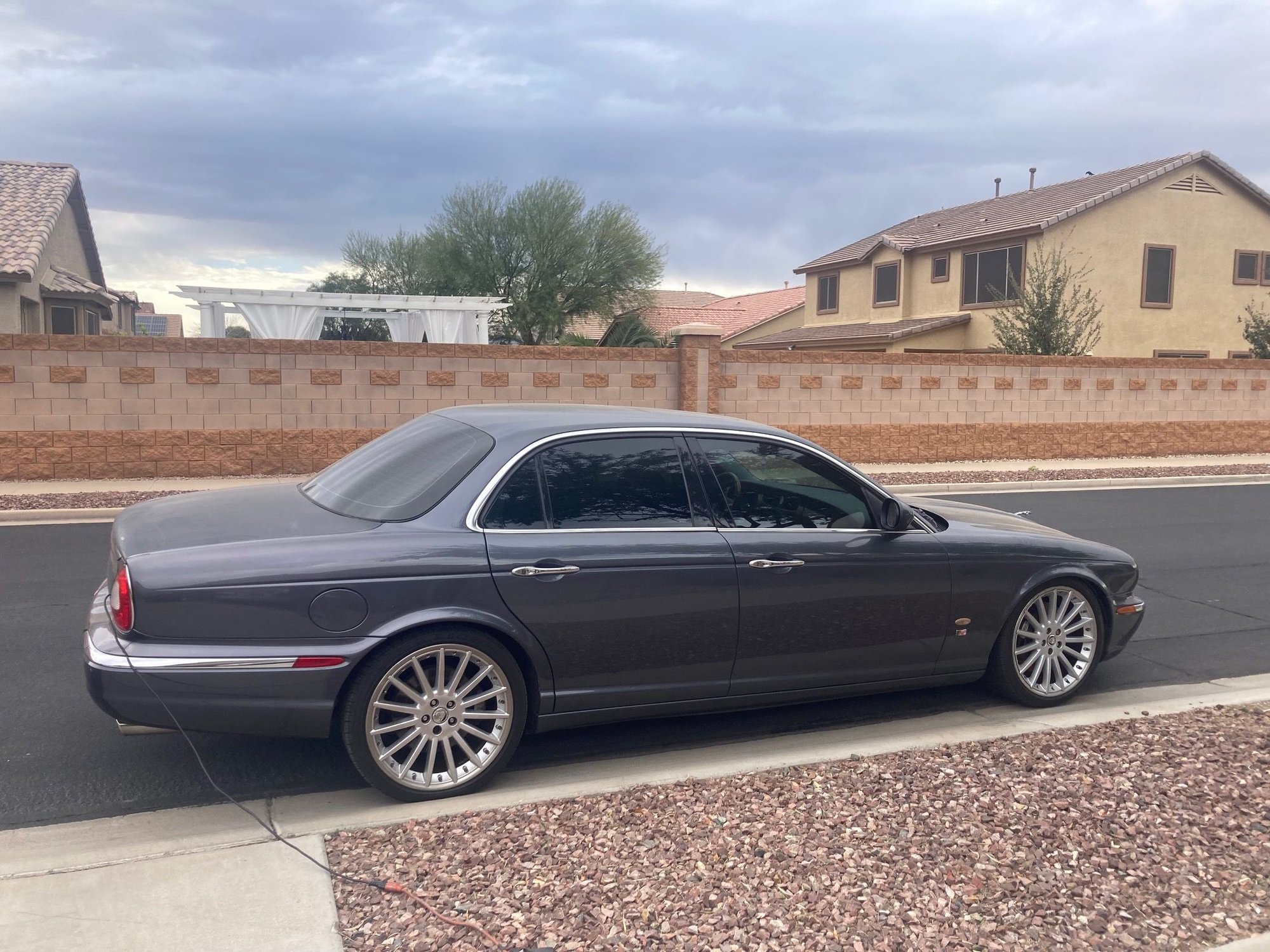

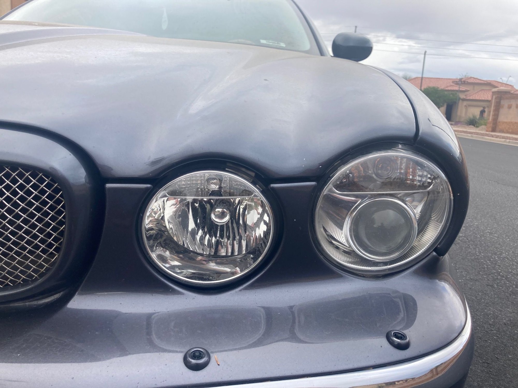

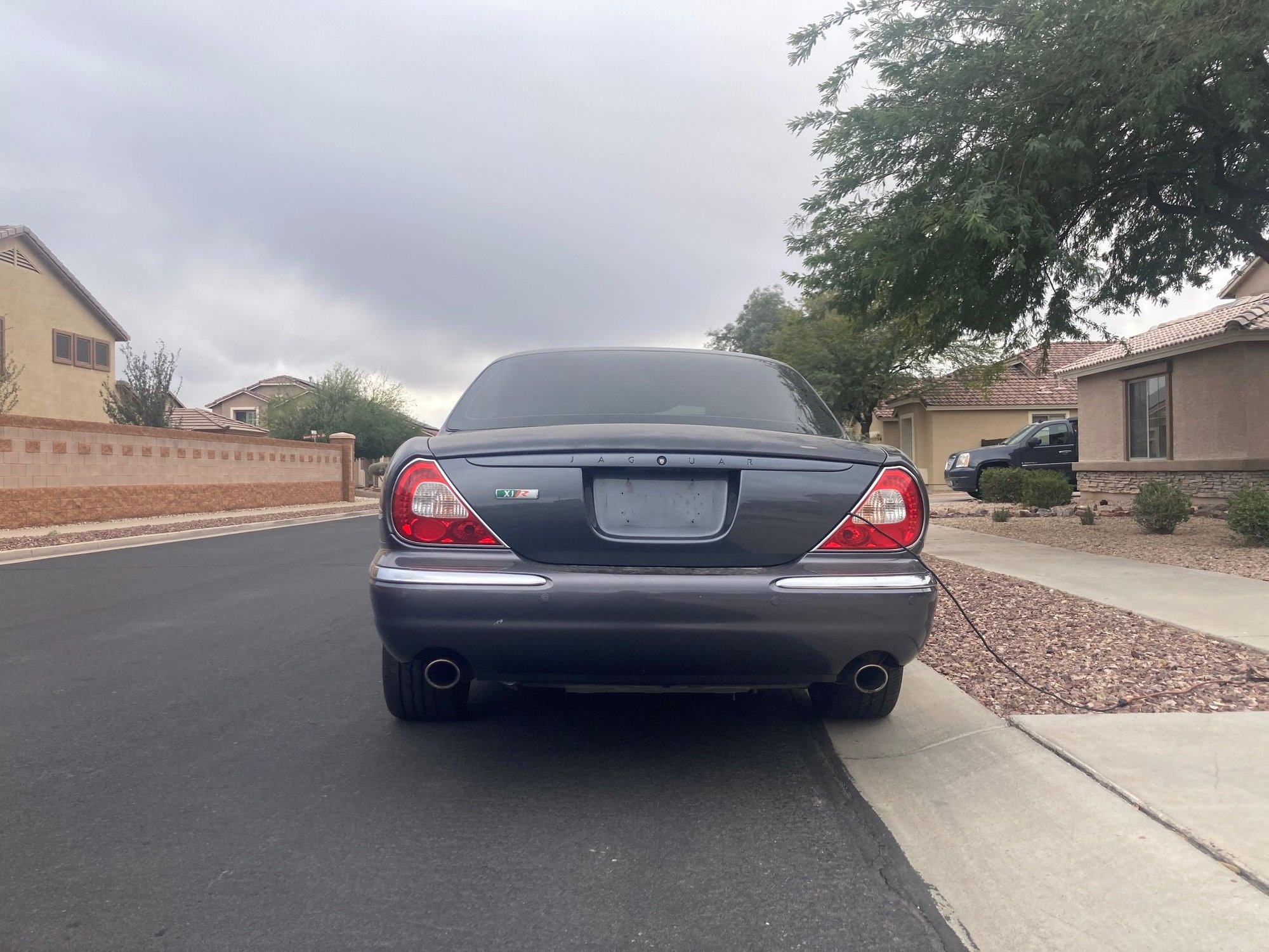

As much as I want to fix the car my rough guess-estimate to fix the KNOWN issues is as follows. Car is 2006 XJR with 122k miles on the odometer.
  • $500 to repaint the boot/trunk.
  • $500 for headliner.
  • $5000 to replace engine ($2k for used engine $3k for labor).
So right there is $6,000 just for those issues, then the front suspension needs to be looked at (it sags overnight) and I don't know the condition of the transmission. The final straw is that the car is a missing title and I never dealt with that before so I'm unsure what the cost and difficulty to get a new title would be.
Current values for these cars are all over the place but I think I can find a craigslist example for about $5,000 with non of the above issues. I believe my car is worth saving but unfortunately my pocketbooks are slim. So as of right now, especially because the title thing and not knowing for sure if I could actually title it, I am deciding to part the car out. Hopefully their is enough interest to make some money out of it quickly.

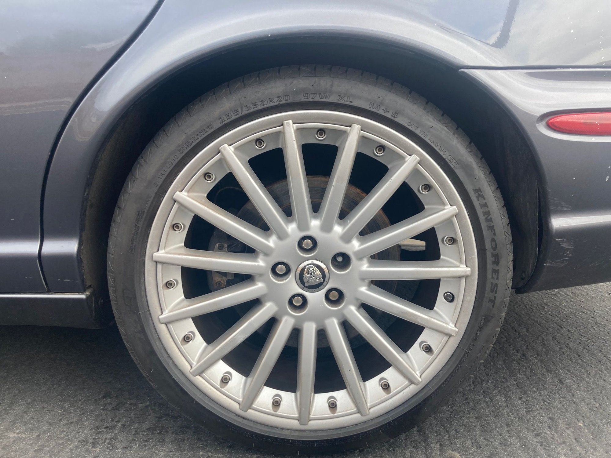

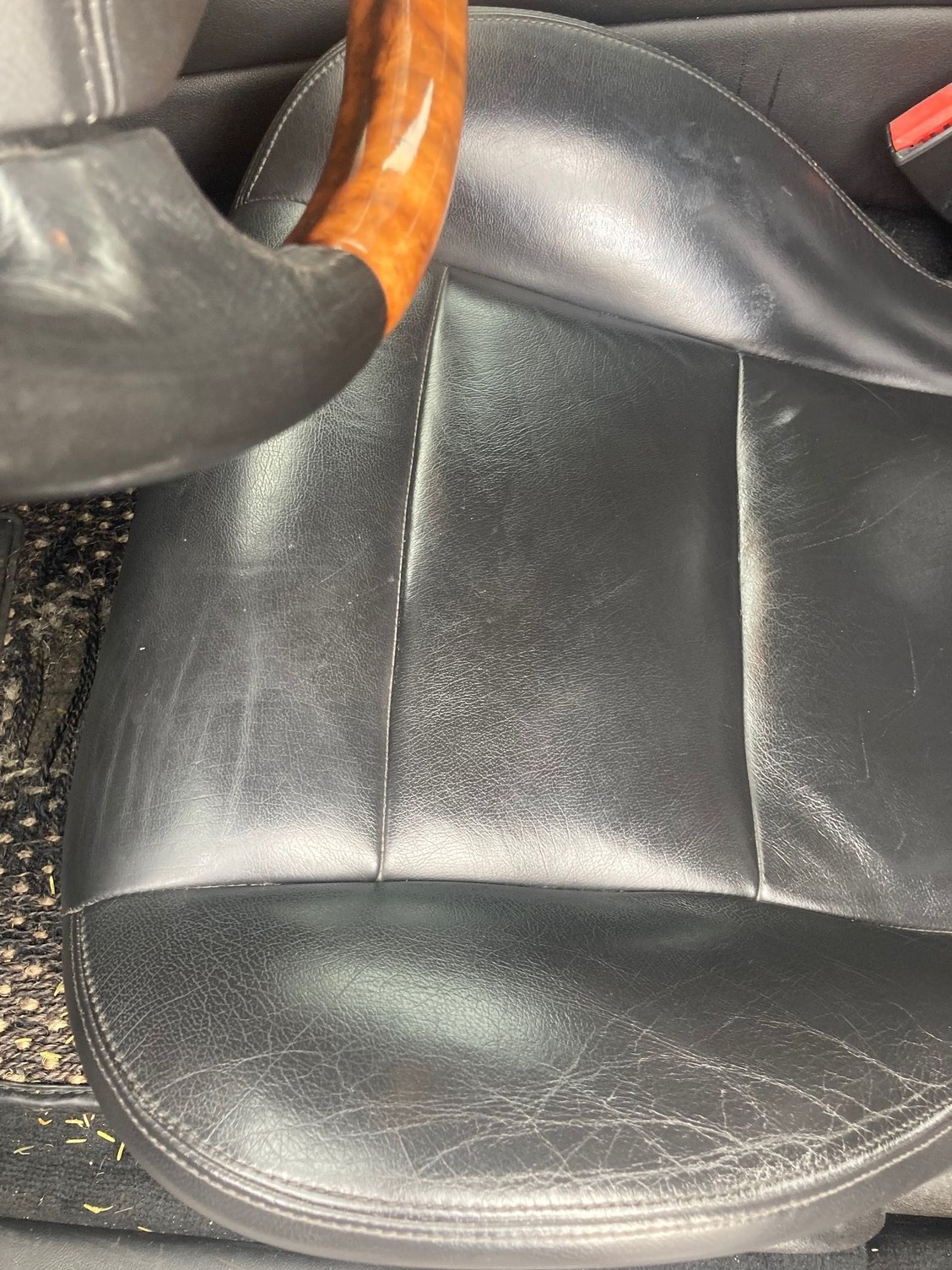

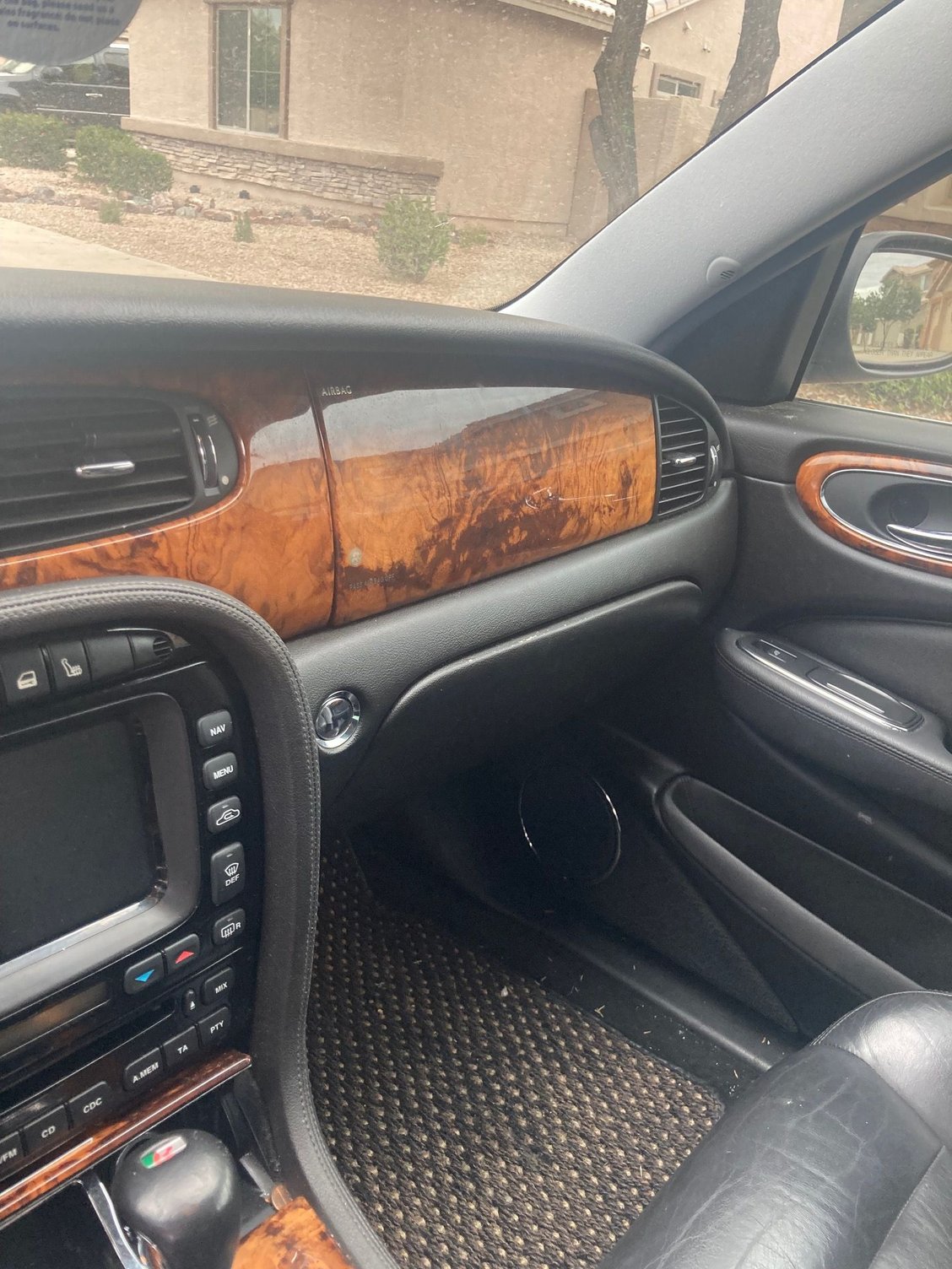

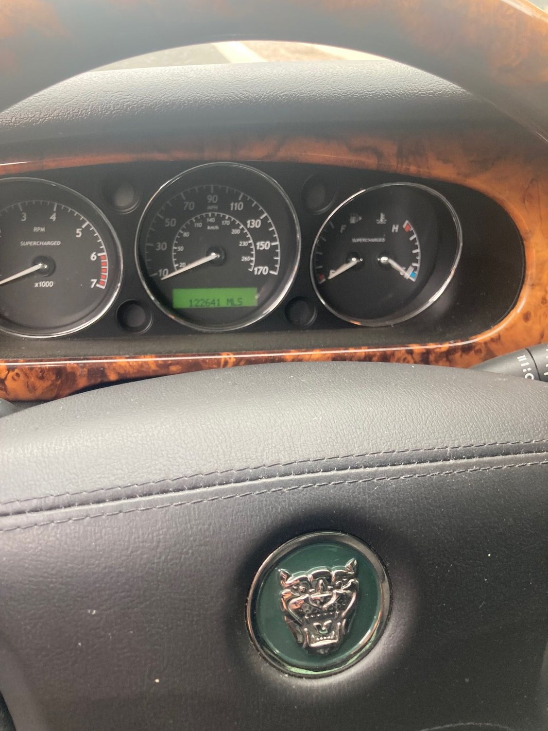

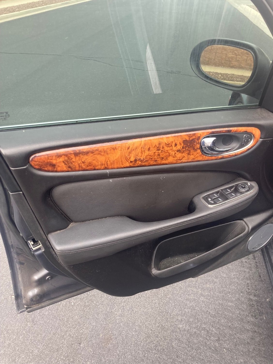

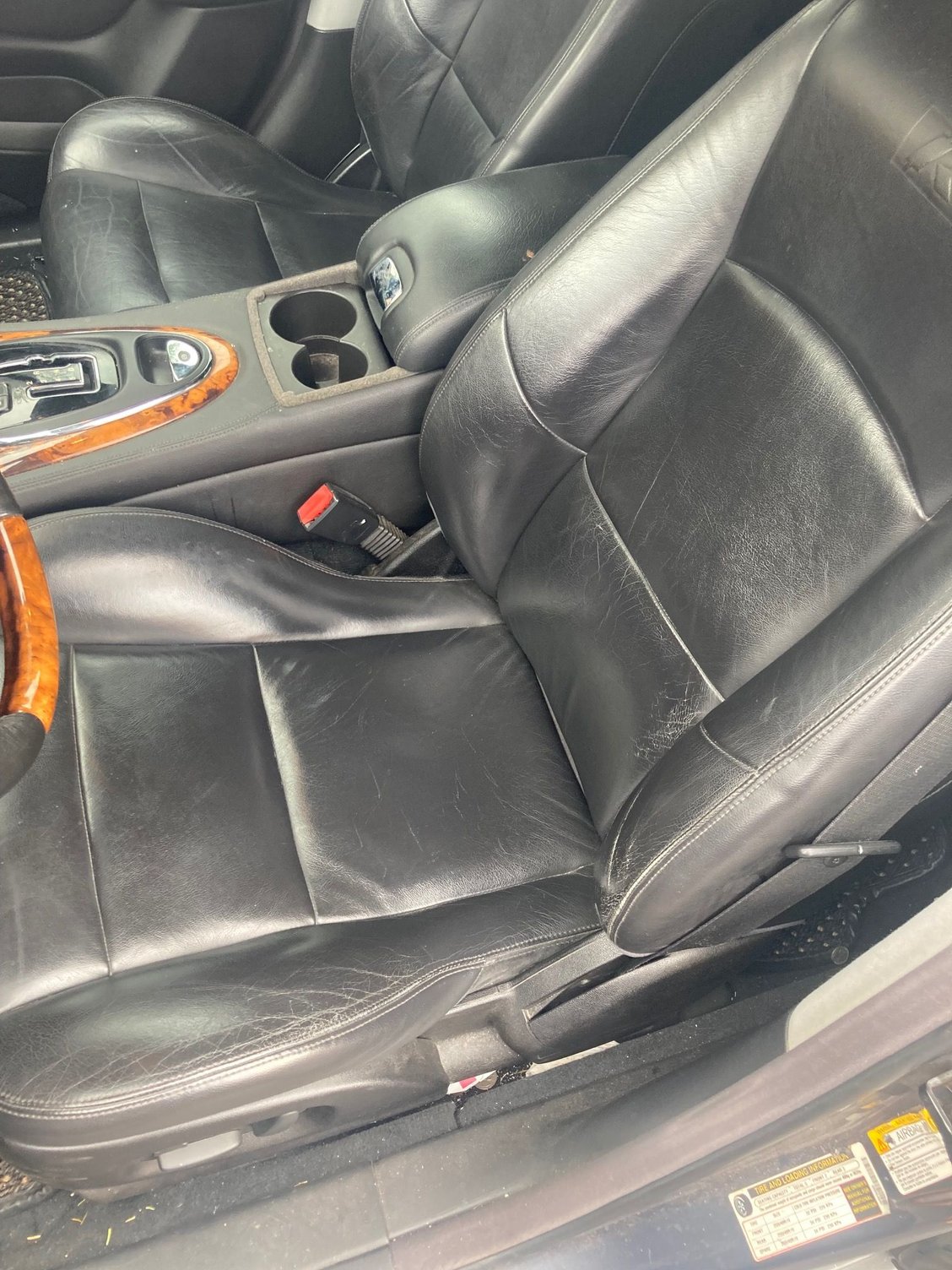

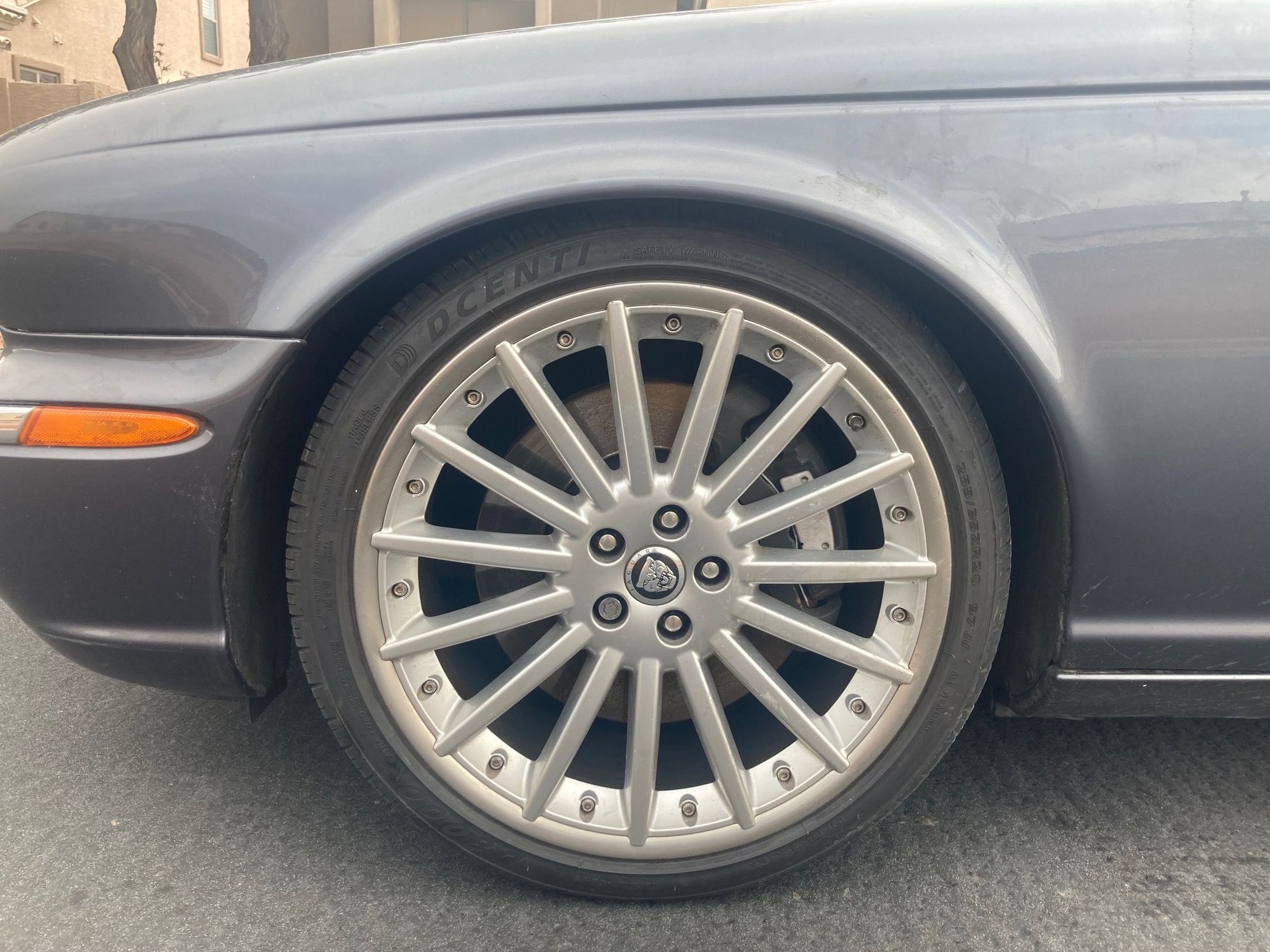

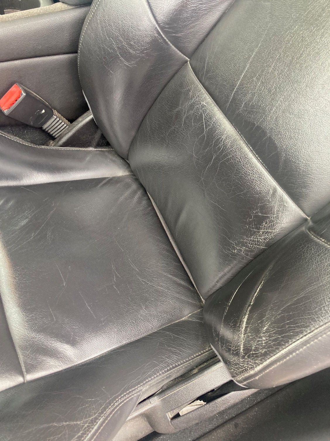

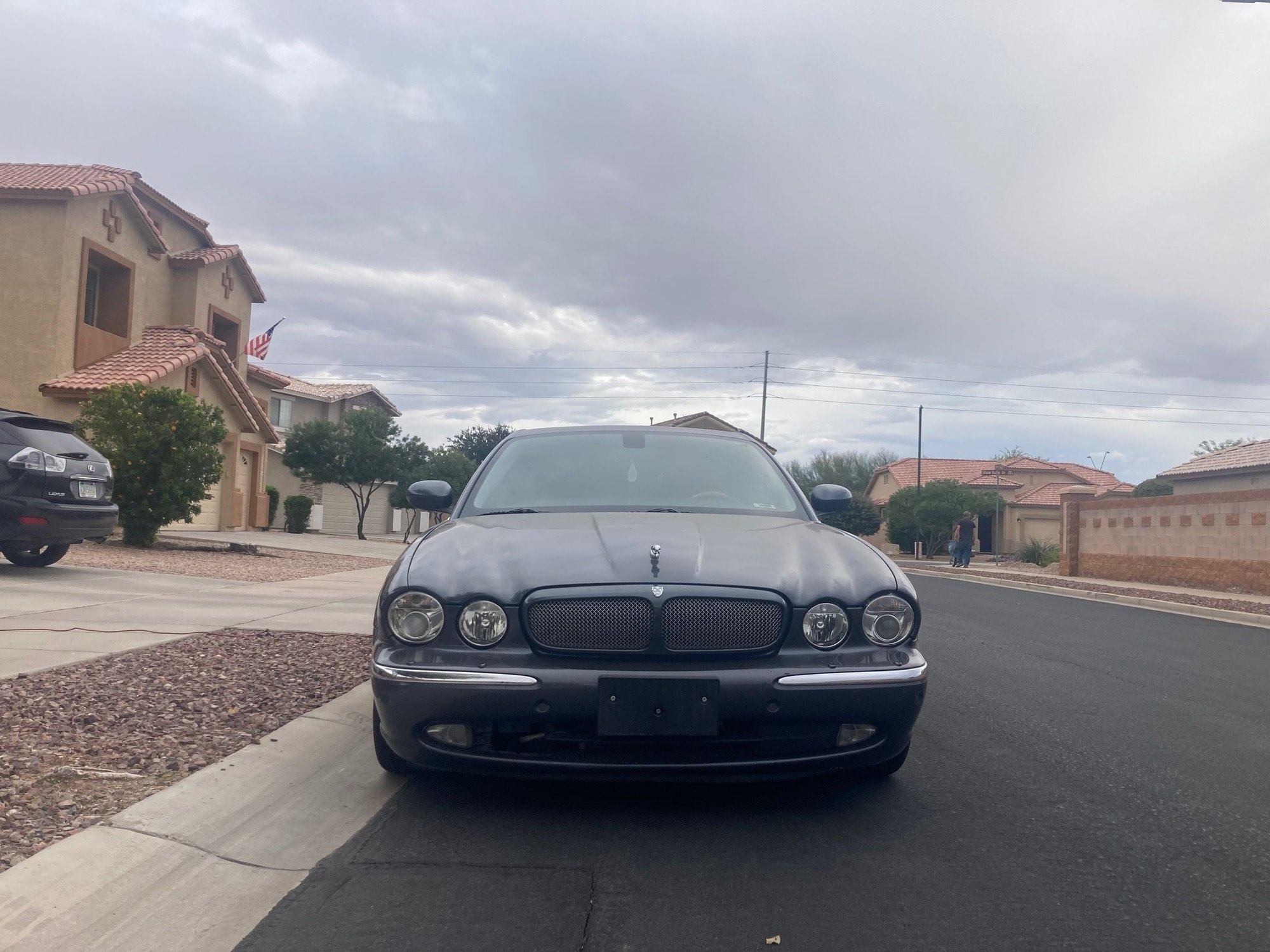

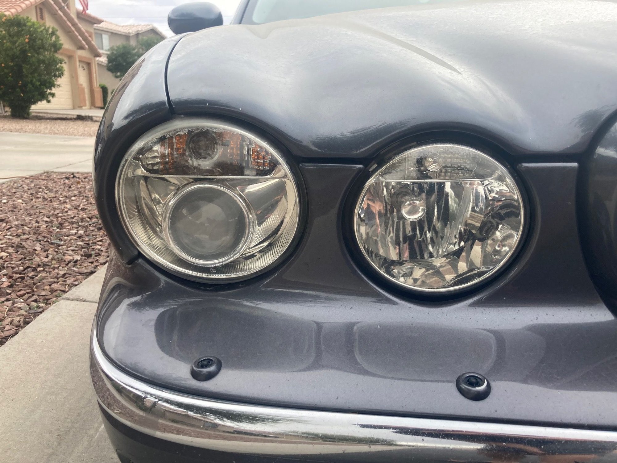

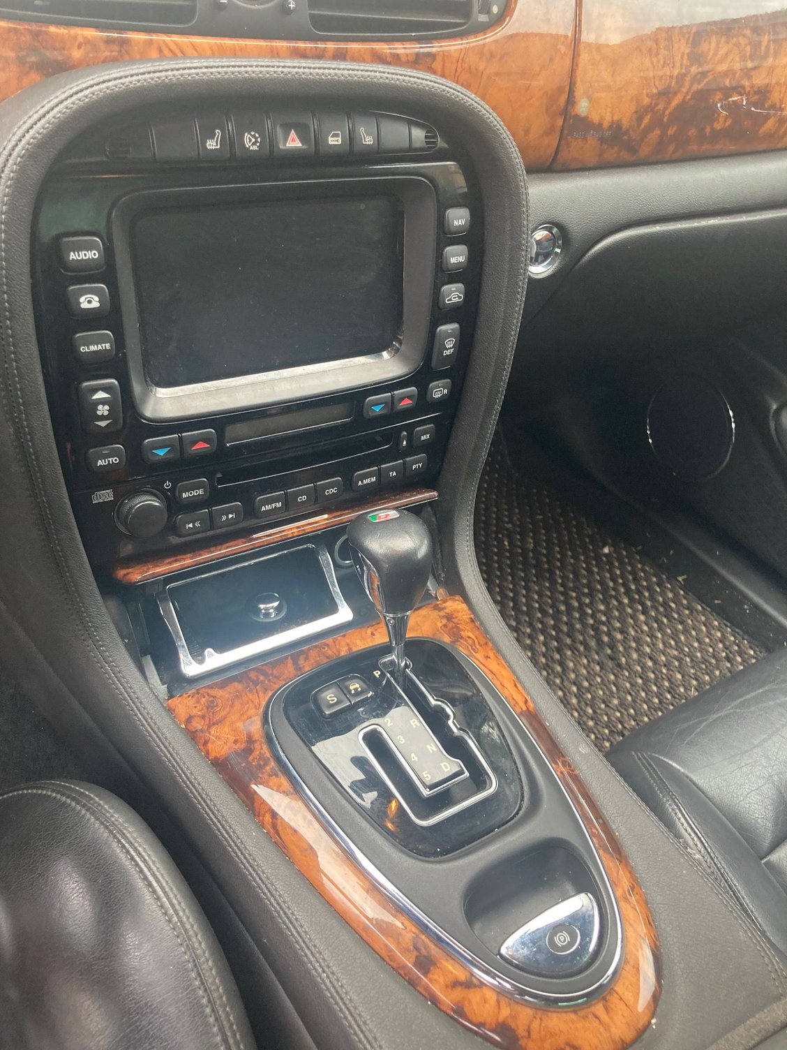

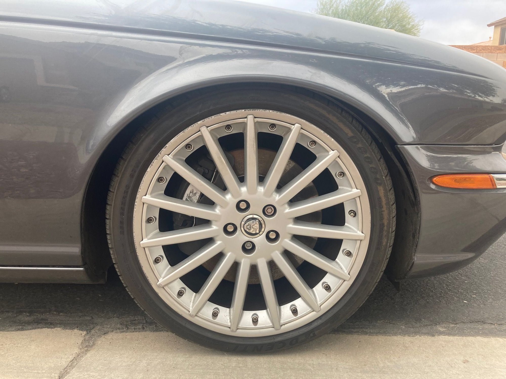

Here are the pictures of the car. Haven't cleaned it all. Cost was $850 and about 4 hours to get it parked in the front of the house and hearing complaints from the wife lol
