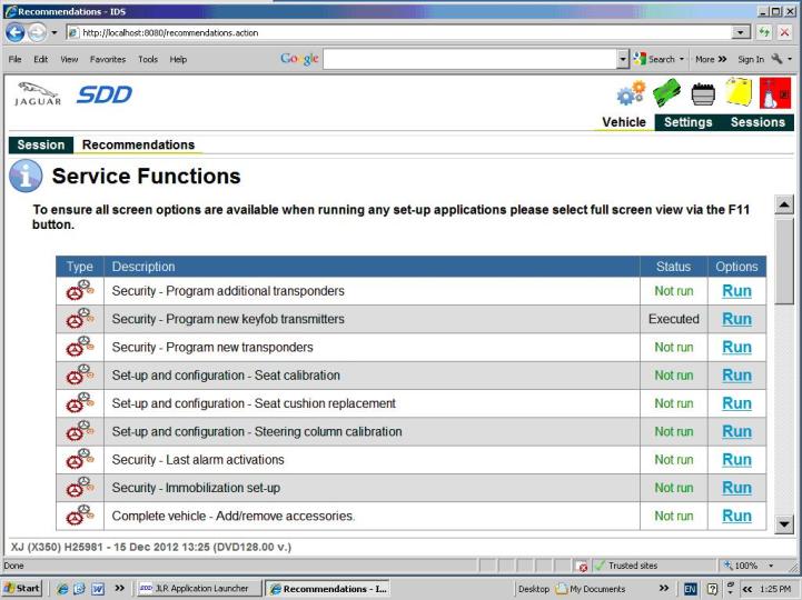

Here is a screen print of the SDD screen on programming keys from SDD version 128. I am not sure which menu option below you chose to use but each one is different in programming your keys.
First you do need to have all keys ready, so you do need to have the key cut and thus keyfob ready for SDD programming. What happened is that SDD errassed the transponder code with your car (transponder chip is in the upper blade portion of the key fob) and thus your car will not start.
In programming key fobs there are three menu choices:
"Security - Program additional transponders" - which will program additional keys (upper portion that has the transponder chip)
"Security - Program new keyfob transmitters" - which will put you through the steps of reprogramming the entire key fob (upper portion that has the transponder chip as well as lower portion that has the buttons) which means first all existing keys will be errassed from working with the car and then reprogrammed by following the SDD steps.
"Security - Program new transponders" - which will program the upper portion that has the transponder chip)
You could try "Security - Program new transponders" to get your one key programmed again. But I would first get the key cut and then with all keys in hand run the "Security - Program new keyfob transmitters" menu option.
I wonder what the difference is between "Security - Program additional transponders" and "Security - Program new transponders" if they both program the upper portion of the fob with the transponder? Wouldnt additional transponders always be new?
Old Mar 1, 2015 | 10:39 AM
lcmjaguar's Avatar
Joined: May 2012
Posts: 737
Likes: 255
From: Wisconsin
The first is for programming additional transponders and the other menu is for erasing all existing transponders and reprogramming a new set of up to 8.
Old Mar 1, 2015 | 11:05 AM
hafren's Avatar
Joined: Sep 2014
Posts: 721
Likes: 277
From: Dayton, Ohio USA
Thanks for the clarification. So "Security - Program additional transponders" should keep your existing transponder 'signature' in ECM and any additional ones get added. This is very helpful to know so as to avoid the issue Ragman had in loosing the ability of his one key to start the car.
