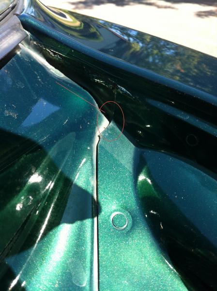

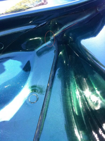

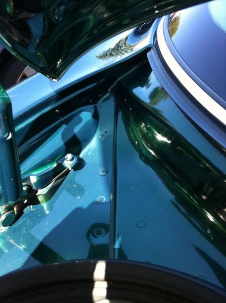

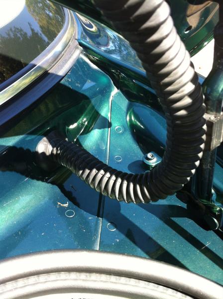

I think I've found it!
There is a seam which can be viewed once the lid to the boot is raised. it is slightly forward of the mount point for the hinge, on both sides of the car, in the 'drain channel'. It was interesting to see that there was a 2mm gap between the lower and upper plates! And the opening of this seam is facing the wrong direction!! It faces forward, counter to the draining direction! Imagine if water froze in there.
I will be sealing this gap myself. If I can manage it, I will take pictures, today as well..

Leak points!
mr merion - that scope thing looks like a brilliant idea! thanks for the link, if i get desperate i will investigate that.
912guy - i have used some sealant tape (i had some in the garage, it's the same type of thing as sealant but used in bathrooms around the base of a sink or toilet where it meets the floor). i've been enjoying the rare sunshine in england so have not fully tested the results but an immediate hosing didn't lead to a link.
guy - thanks very much for taking the time to take those photos. i had already spotted that issue on mine and have already sealed it up. it was actually one of the first things i spotted when i was first investigating the leak, so got it sorted immediately. unfortunately, this means that it is not the issue.
i will update this post once it's rained a bit (not normally a long wait over here!) or i get time to get out with the water hose again but i'm going to denmark for a few days so will have to wait now.
