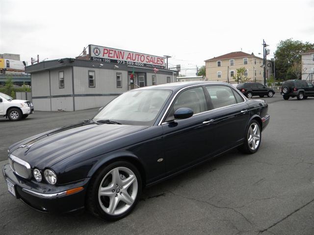

Thanks Guys, looked all around and could find a clean well running XJR so picked up a 2006 XJ8L Indigo Blue super clean.
Attached Thumbnails Looking at 2005 XJR's-used-2006-jaguar-xj_series-xj8l-10555-8662441-3-640.jpg

Good luck with the new jag, Looks great.
