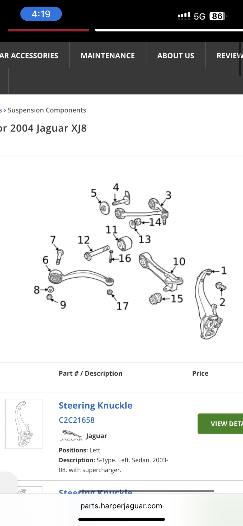

I need
part 13 and part 14 where do I get those?

It’s the lower control arm camber bolt and nut where do I get these as these are one time use and mine are cut off

I would think that any proper sized locking nut with nylon insert works. The camber washer is available from SNG Barratt

Here's the page of the Jaguar parts catalogue for the X350.
https://parts.jaguarlandroverclassic.../brand/jaguar/
I assume that the parts you are looking for are nos 10 and 11 in the picture in the link, is this correct?
No 10 is still available at Jaguar, no 11 is not, but if you search for the part no. you will find it.
