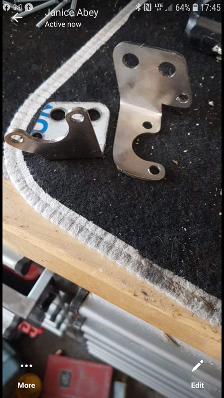

To lower the rears without a computer you need to move the rear sensors up,towards the body, i have made some laser cut rear brackets for the sensors that are shorter and give 20/25mm of drop,if you want less then you can shim the bracket down again. I sell kits to do this but am in the UK, Fronts too.

No link its a hobby and i sell a few. Picture a standard pair of rear brackets laser cut from stainless but 8mm shorter.I also do laser cut shims in various thicknesses to lower the front.
Its not as precise as SDD but if you dont have the computer adjusting or changing the heights is an hour of your time on your driveway.I will put up a couple of pictures if you want.

Bolt these straight to the car and it lifts the sensor towards the body and lowers the car around 20mm ish. if you want less put a washer between the bracket and the body.
