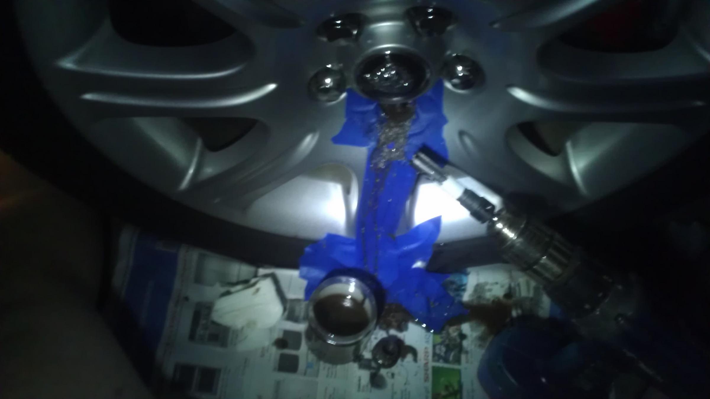

It took about 30 minutes but it worked.
9/16" hole saw (carbide tipped), low speed, lots of oil.
Once I got going I removed the drill bit so I still have the stud.
I'll take the wheel off later & take another picture.
I replaced all the other lug nuts with solid ones.
It took a 4' pipe to get them off. Damn air guns!
All the threads were rusty too. I'm using a thread lube this time around.
(originally posted in S forum)
