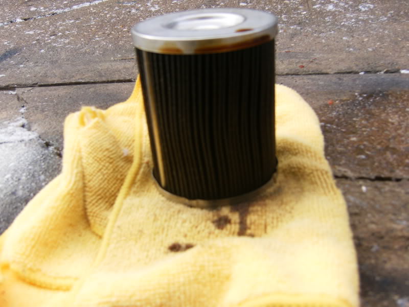

Heres a pic of the canister and part number
a pic of the componants inside
broken down oil on the bottom of the canister
a pic of the anti dran back valve, and proof thats its been used (bad thing)

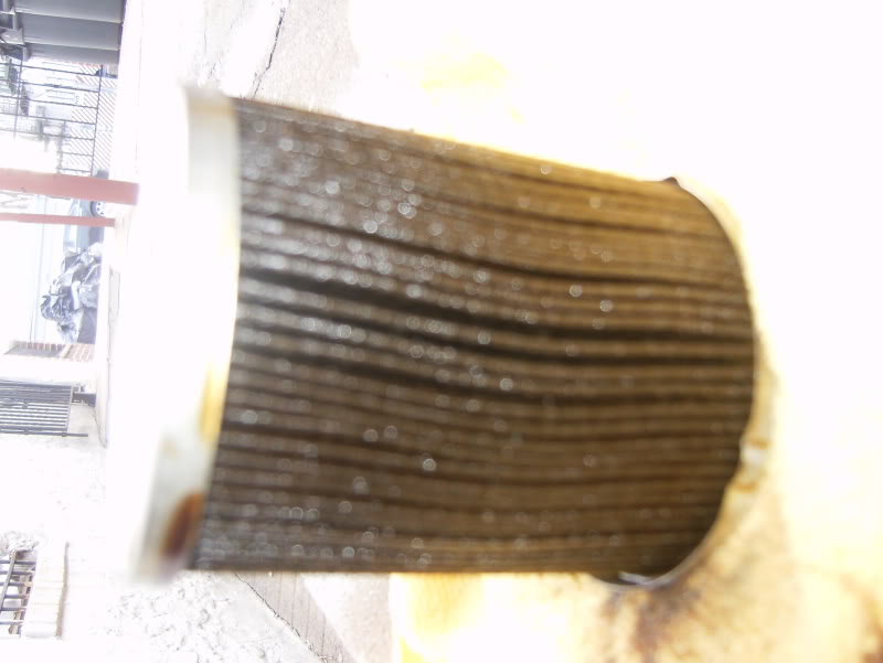

filter element
as you can see its warped, that a sign showing that it has been overused. in the next 2 pics youll see little white marks. those are like peices of lint or fabric, hard to tell because of my crappy point and shoot camera. but the whole filter is covered in it, and the filter is also visibly full.
What to make of these photo's ? experts chime in but my take is a few things.
10,000 miles oil change intervals are a no go using conventional oil and a cheap filter. This is after 8,000 miles of mostly highway driving.
The fram filter while being cheap surprisingly has alot of filter sleeves and metal retainers, I thought I would find glued cardboard holding the element together.
I accidentally threw out the oil filter with 500miles on it, I really wanted to see what the actual element inside looked like. It was an STP filter but i wanted to see if any dirt or dust particles were on it like this one. Next week or so (once the car hits 74,000miles) I'll be gutting the current oil filter with 4,000 50% city 50% highway mileage on Castrol Syntec to see what shape its in. I hope the MMO cleans out the motor.
I know this is on an XJ but the motor is the same between S-Type, XK, and XJ. Also this vehicle was adult owned and maintained ( as are most jaguars coming off lease or finance ).
Let me also add that the motor runs very very smooth, and pulls like a beast. Thats really the surprise to me

Stating that the oil bypass shows signs of activation is correct as this is a normal part of operation even with new oil and a new filter. The bypass opens at every start until pressure is built downstream of the filter.
I believe the filter element distortion is also normal as they are crushed slightly during the assembly process.

heres a picture of an unused fram oil filter and a few others as well
they dont looked crushed to me.
